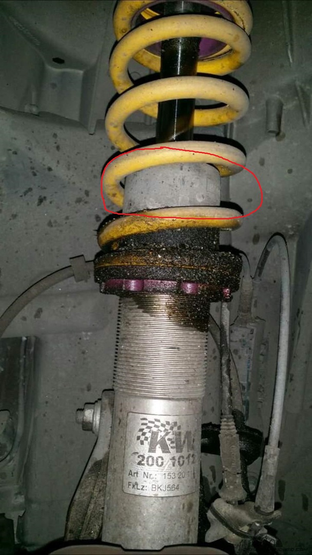

A very bad day indeed...
still can overhaul the suspension...
Why in between shaft area and oil patch no oil? Usually if leak then whole absorber will be oily, right? Mine does.....lol
This is a monotube, hence usually the shock body is inverted, so the oil has tendency to go down, so you dont see oil on the shaft.
Yes, but if leak will be from shaft, but area about the oil patch is dry?

why not doing full servicing the used set before install... ideally thats the best practice
Could be a factory defect, but I'm still not sure why either.
hope they replace one on one. Something not right for 3mths old bought new suspension.
cylinder wall, seals ...etc already defect from factory. Don take it for service.
Depends how the warranty is given. Some will repair only. Only if cannot repair they will replace. Hope bro. s.marz keeps us informed.....:driver:
Will keep this thread updated, gonna have it replaced on Monday :)
