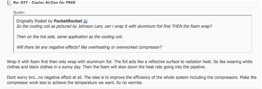

thanks bro, will do it after my shift cycle is ended. this is beneficial to a kancil where aircon is not that cold on a hot day
Yup, hot day is not that cold indeed. Only at night is cold enough. Intend to try since is a affordable DIY.
hmm..well by right it shouldnt because if it is then we dont need to compressor to bring it up to superheated state in order to enable heat rejection to the ambient.
So should we wrap both or liquid line (cold) will do?
SF, our plastidip sifu Pocket Rocket told me that better wrap the lines with aluminum foil then only wrap with the aircond insulator.
Should be the other way round wor...wrap the insulation then wrap with foil. The foil will act as vapor barrier and also radiant heat reflector
Both lines or only the cold one bro? Those wrap garlic bread kind of foil?
KY wrap the cold line first. This is the low pressure line so if more heat goes into it and it exceeds the "superheat" design temp, the compressor will not work as efficient. Then wrap the hot line which is the high pressure line, called the "subcooled", if it feels colder than yr engine bay.
Oh ya, actually if the load is too low, there is a risk of liquid going into compressor and shorten its lifespan. But in our climate that seldom happens coz its freaking hot !
both lines kua. yeah that type of alluminium foil.
U mean the high pressure line colder than my engine bay? How to tell which is hotter?
could be also, need to re-confirm with him.
Now I'm Confused by 2 Confucius :confused:
SF, the cold line you will see water condensation on the pipe one...
Labour for doing house is not cheap be it fixing or installing...that's why if can DIY, just DIY.
Nowadays such man hard to find nowadays. :adore::adore:
Ya know that bro, just wondering whether need to wrap the hot pipe as well earlier.
Will wrap the cold one for now.
Danz I found Air Cond Sifu Cvkit reply to Pocket Rocket.
