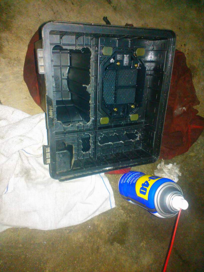

Fuiyo.. eh take pics and post as a DIY la. If you cut the hole in the resonator did you cover it with a breather or some sort of filter? Take pics share share la.

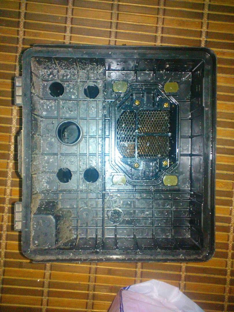

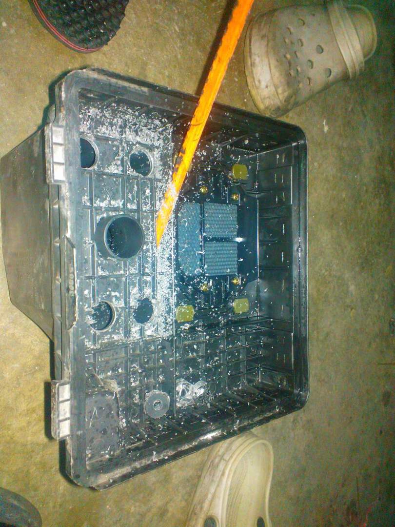

i didn't cut hole for the outside air to come in...just make a bigger opening at the resonator "small hole"....so it transformed from a resonator into "surge" / collector tank of filtered air.....tomorrow i'll post some picture..... (at first i did this to give a bigger filtered air capacity to the MAF sensor because i tought my MAF sensor not getting good responds) :biggrin:

iszo..here is some of the picture i manage to snap during "korek-korek" :biggrin:

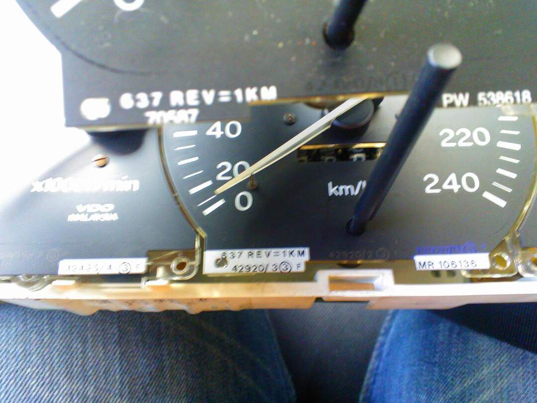

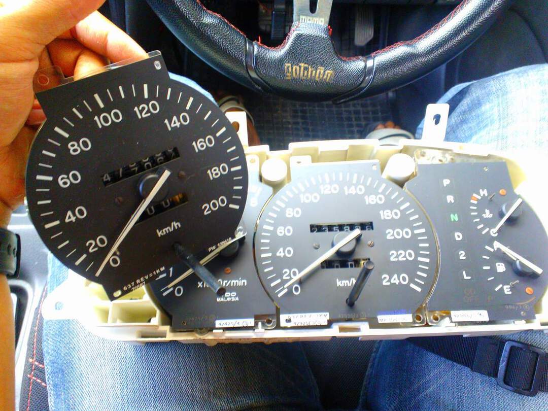

*bonus picture: speedo swapping and reaclibration....speedo shows 100km/h gps shows 101km/h :biggrin:
