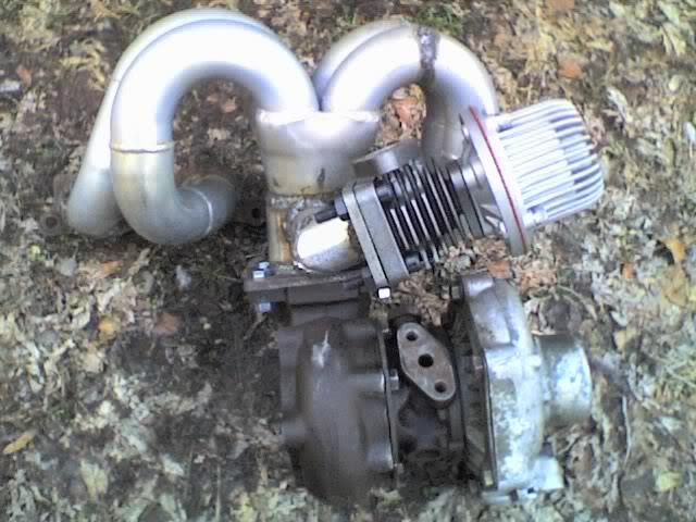

u can either put ur wastegate on ur manifold, or also can put it on ur o2 housing , u weld only the flange to ur manifold or o2 housing , then clamp it to ur wastegate using bolt n nut , can see the pic below
http://i5.photobucket.com/albums/y179/jimboburgess/01-16-07_1624.jpg
and this is a pic how a stock 4g63 manifold with tial wastegate
http://www.roadraceengineering.com/parts/wastegates/tial-36mminstalledon2gmanifold.jpg
i believe ijal exhaust does the tune-length banana, including those remote turbine extractors. give him a call at 0166396700
