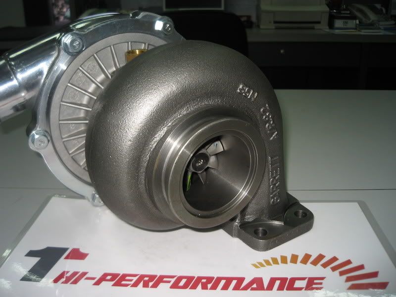

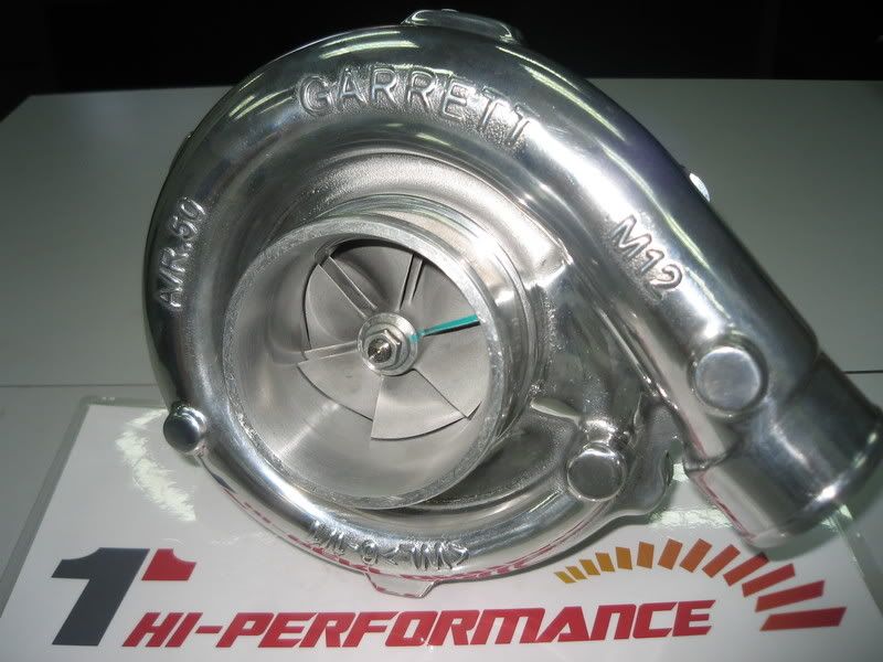

We're pleased to make a hybrid T3/T4 launch....Special ZTH price..
RM 1,888 /pc
Front : T04E - 60mm wheel
Rear : T3 - 55mm wheel
All PARTS are GENUINE GARRETT.
Why risk buying non-branded turbos ? Insist on a Genuine GARRETT.

if we see in term of trim
60mm means wht trim la bro , hehe , mau cari this turbo specs/map
sdf this turbo can go 400hp ka? can u give the spec.. wah nice turbo berkilat hehe..

we'll put it at 350 on wheels.
no warranty for motorsports turbo mate.
for more boost, you'd need a 360thrust bearing kit, add on RM 400 please.
