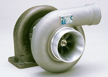

well everyone has their point here... GREDDY turbos are pretty good for journal bearings and their designs worked well...some of the new GREDDY series uses new designs, mainly taken from the MHI new improvements...
similarly Garrett T series were old tech and now moved up to GT series...
:driver:
latest trim comes from the TF series... which GREDDY currently uses on the newer T88-34GK...

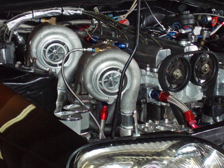

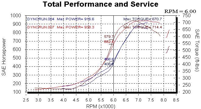

Bump: how about this setup..
s256x2 unit on 2j...Done by TPS (Total PERFORMANCE AND sERVICE)
SEE THE RESULT
A comparison between twin Bullseye 56mm non ball bearing, to Turbonetics twin 58mm ball bearing turbos. Bullseye twins work much better.Both sets ran 37 lbs of boost with a cap on the header instead of a wastegate. The Bullseye turbos were S256 with .75ar’s, and the Turbonetics were 58mm ball bearing with .81ar’s and Q trim back wheels. The other mods to the car are rods, stock compression pistons, ported and polished head, cams, stand alone engine management, th400 auto trans etc.
