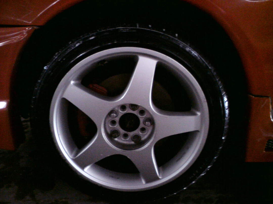

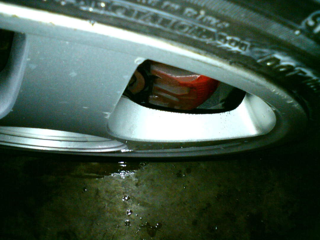

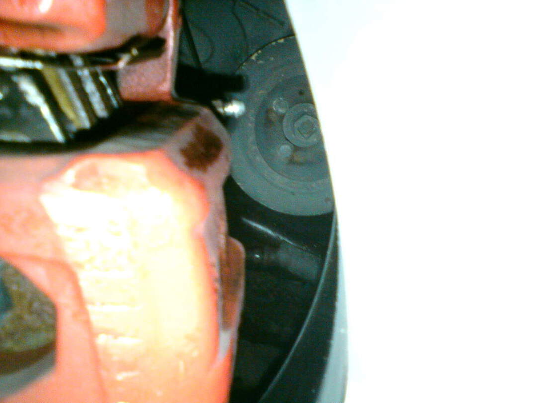

currently bought a set of japan recon rim at halfcut , 17x7jj , 10 holes, but sadly , i dunno wat rim is it ,it come with rim cape but do the brand on rim cape can be trusted as the brand of the rim??, i really need to know bout the rim offset but it is not written on the back, any sifu can help? i currently run on e4 twinpot , the distance between the caliper to the rim spoke still got bout 2cm, is this enough to fit e5 brembo?? help:adore::adore:

u flip the rim around and take a pic of all the words/markings, post here. i think easier for ppl to help you see... as for clearance, my caliper to rim is only like .5cm... still ok

the rear words so blur, corroded since halfcut, but can see words like ET , JPN , 6/26(in a circle), 28 or 38(in a circle) ,that is all, other than that is written in front of rim, 17x7jj,680kg etc....
i din mean is it enough to have 2cm clearance for my current e4 twibpot, i am asking the 2cm extra can clear the brembo or not.... btw, anyone know actual size of the brembo calipers? far bigger than e4 twinpot?

Try and take each rim, use some really concentrated cleaner like dynamo or something to rub on the markings... Shud be 38, in which case that wud be your offset

i used acid dy :burnout: but nvm, founded a way to calculate offset myself, even not that accurate but should be okay

7jj cant clear your brembo 4pots ler...
u need at least 8jj or 9jj offset not sure hehe....
i also not really sure, but 8jj rim in wira is a bit :stupid: sure hit the side since too wide... wat is the min tyre width can mount to 8jj rim? 205 can? but some 7 jj can clear brembo also le:hmmmm::hmmmm:

actually, rim size determine how big ur rotor can go, offset is the measurement from the center if rim to the spoke of ur rim,offset determine the caliper size u can go....

It depends mainly on spoke design of your rim. also, offset play quite important aspect.
I dont know really what's the rims requirement to fix 4pot brembo from E5. but definitely, it's not necessary to have 8jj width... even, OEM rims of DC5R is 17x7jj with the offset of 60mm (IIRC)... still, it can accomodate 4pot brembo..
Like i said, spoke design comes first, follows by offset...

min offset, if follow by the e5 stock rim, is +38 .... dc5r with +60 offset O.o ? i din know that, the biggest offset i ever heard
