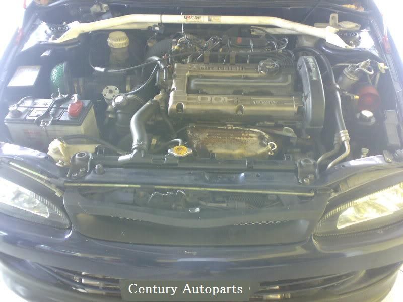

He3... Maybe the White powerful Satria didn't tell U about my story... The story goes like this...
FROM:
TO:
Hehe.... TLN rite...?
