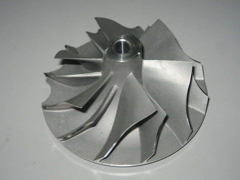

For TD05H series.. most people go for a Garrett T04E wheel, which is workable, BUT not the best combination.
For TD05HR series (Evo 4-9).. i've posted in Evo forum on the 20G wheel available. Since you're asking..here you go again Kenzo.
