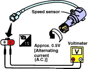

can i know, where can i tap digital speed meter in my car. which wire?? i use mazda B6T.
:itsme: dear subaruimpreza81;4117787 is hard for me to explain the proper answer to
u....:banghead:
where there are few type of model that will take me century to post it!!!:listen:i'm a slow typewriter :argh:
:biggrin:So to make this easy for everyone:biggrin::biggrin:
:nurse:Let me teach something easier.
1-Ready a multimeter!
2- Find out what type speed sensor pick-up point! Majority is speedometer and gearbox speed sensor.(see picture:rolleyes:)
Speedometer pic1 and 2> the sensor output is just behind were the arrow point, some u can see the sensor or just 2pcs (+)screw!!! :biggrin:One of it is output!
Gearbox speed sensor pic3> the output is on the speedo gear itself, is simple! On to IG, use multimeter trace the socket pin from ecu. Find the one that not (+)5v supply!!!>For 2 wire.
Find the one not (+)5v and strong (-)Gnd supply!!!>For 3 wire.
3- After u got every thing done, Dont forget to adjust the DIGITAL METER speed ratio!!!
:nurse:If your car dont have both:biggrin::biggrin: Ask me for plan B!:biggrin:
Hope this help!
HAPPY TRYING!

i use speed sensor on 2nd pic. how??

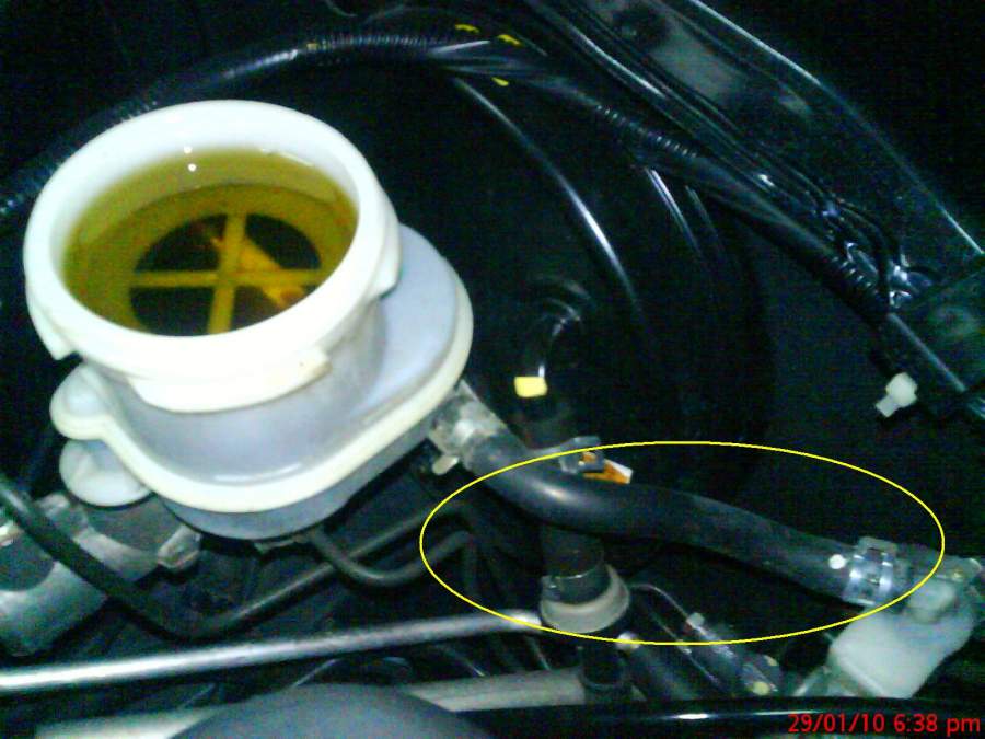

brake servo with master pump...evo 3 :biggrin:
:itsme: subaruimpreza81 as u using the 2nd pic item, u should remove the dash meter to find for the speed sensor! Pls upload a pic of your meter front and back, if u not sure which part to look for!:biggrin:
:biggrin::itsme: dear admehdivkia for my advise, :rolleyes:u should go to the workshop to let the expert do this job because of involving your braking system!:biggrin:
As a reference:
Tool:
-8mm/10mm pipe spanner.
-12mm comment ring.
-1/2 or 1/4 auto handle.
-1/2 or 1/4 12" extension.
-1/2 or 1/4 uni joint.
-12mm socket 1/2 or 1/4
-pliers
-etc (if u feel easier)
-500ml of dot4 brake fluid.
As a guideline picture:
Step from picture....
:nurse:Caution for pesona(manual) and late model gen2(manual) where evo45678 is needed! See picture 4

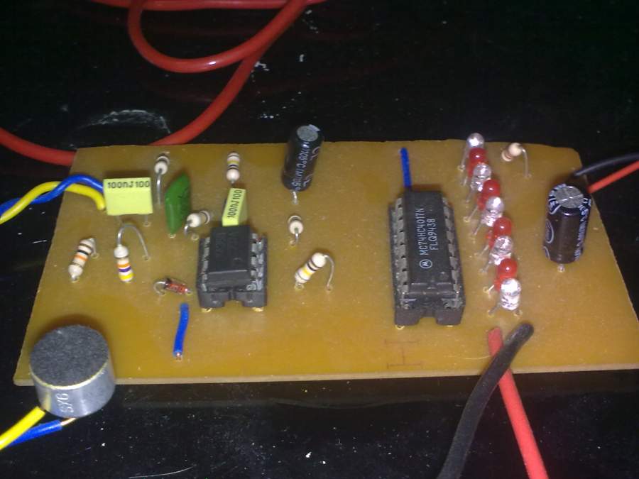

hanslin, i hope u dun mind if i steal kenneth frm u cuz i've done this before. :biggrin:
kenneth225.. if i remember correctly, u'll need several electronic components like a dual op-amp @ operating amplifier (LM358), a 4017 decade counter (try to get the motorola-like in the pic or even texas instrument one) and of LED's la. so to keep it short, just refer this website http://www.electronics-lab.com/projects/motor_light/021/ to do it without hassle. hope this helps u 2 build the circuit.
next is fixing it in ur car. where u wanna fix it at??
1) in the cabin
2) in the trunk
for option 1, u cn tap into the power source frm ur clock. just use a multimeter to check which is the +12 volt input as for the ground, u cn just fix it to any metal part behind ur dash and by any metal part, i meant it has to apart of ur chassis to be properly grounded.
for option 2, just use the power source frm ur tail light, find it using the same way in option 1 and dun forget 2 ground it.
and one more thing, make sure u put some silicone over n under ur pcb to protect it and also on top of any exposed metal parts(component pins) on ur pcb and finally place it in a proper casing. finally sit back n enjoy ur hard work.. :biggrin::biggrin::party::pepsi:
n sifu's out there, if i've left out anything, pls feel free to add in details n correct me if i'm wrong

wah sifu wirahybrid the diagram so confusing haha.. do u have the real photo that can do reference? thx... and hor where do u get those electric parts from? :biggrin:

hmmmm, bro, i think if i show u the pcb board u sure go haywire 1, bt i'll still post it anyways. i did this in form 2 so the pcb design is rubbish and it isn't tht reliable to copy mine. btw, u cn get all the parts at jalan pasar. got lots of shops 2 choose frm or u cn order online fro www.farnell.com ...

haha thx sifu wirahybrid,. i think i jst 4get about this diy bah... @@ those thing too complicated very hard to understand the diagram :confused:
