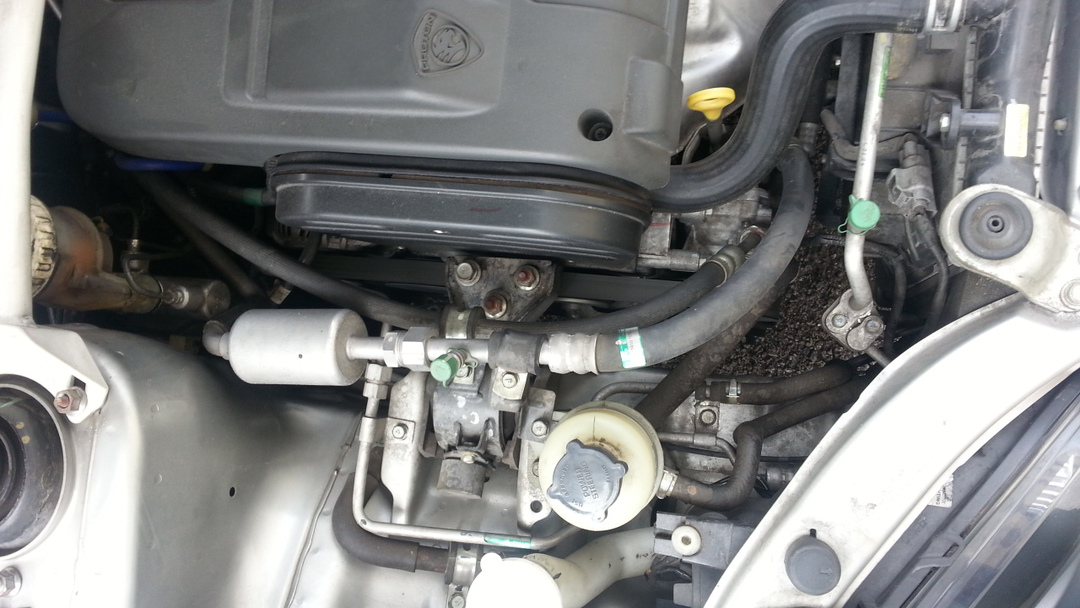

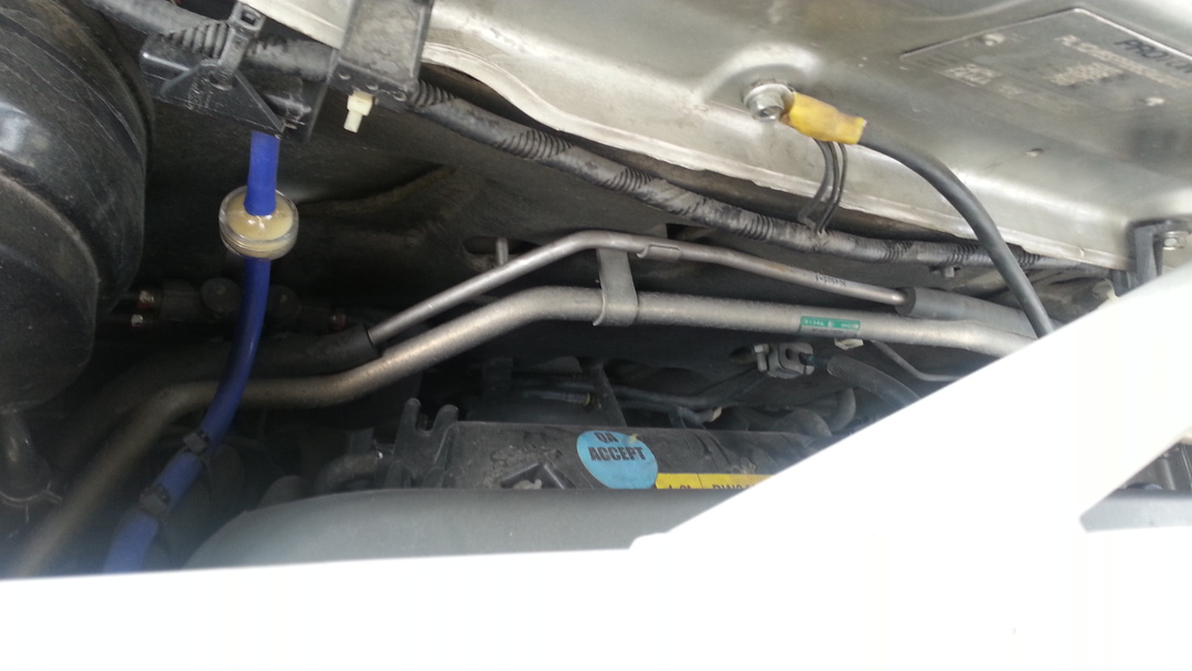

which side should i wrap??? driving persona elegance....
i think should be tat piping near firewall....

I also diy wrap the air con pipe.
already done on :
-waja
-kenari
-pajero
-exora
-blm
hardest is my waja as the engine space is very2 tight.
longest is the pajero and the exora as its equipped with rear blower.
i used the same material but i bought it in long sheet.4 feet wide and i cut a long piece then wrap is around the pipe.
the insulator is also used as sound insulator on my blm.i put it inside the door panel as its hollow.can feel its quiter.
Unless it is a few layer. Anyway this tube easier, just cut the length, cut the side and slip the tube in then cable tie it.
