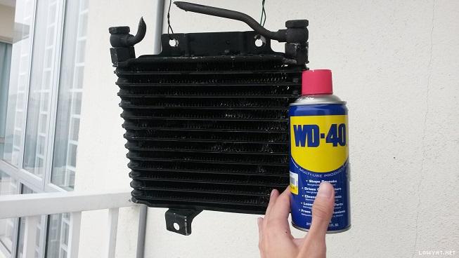

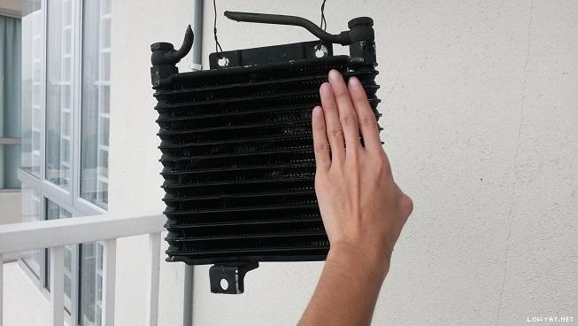

Hi, sorry to bring up old post.
I read through this thread and decided to get one ATF cooler for an Atos. Search in halfcut and found a Pajero oil cooler.
Is this oil cooler too big for my ATF, I asked some ppl they said is too big, so I'm here for some opinions. :itsme:
Thanks in advance

it is quite big....
but i dont think it would cause any damage...probably rpm shift point/lock-up point changed a bit

from the picture....the cooler size is about 3size of your palm....
u should get around 1.5/2size of your palm at max....
which is around 7-11row

The ATF is too big for Atos. In terms of dimension, I worried that the big size may not fit into the void between the bumper of Atos.....

My Myvi one was bigger than that. The issue isn't the rows, it's how it'll fit in if it's too large. I don't think it's an issue fitting that in your Atos though. That's my opinion.
