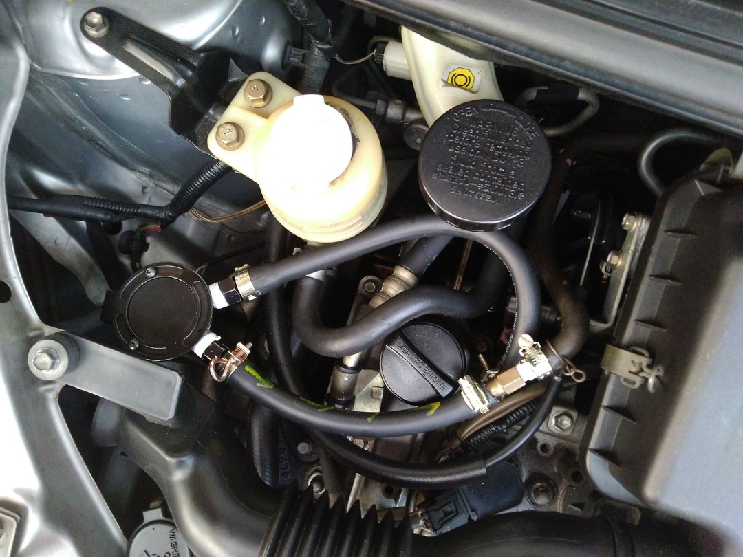

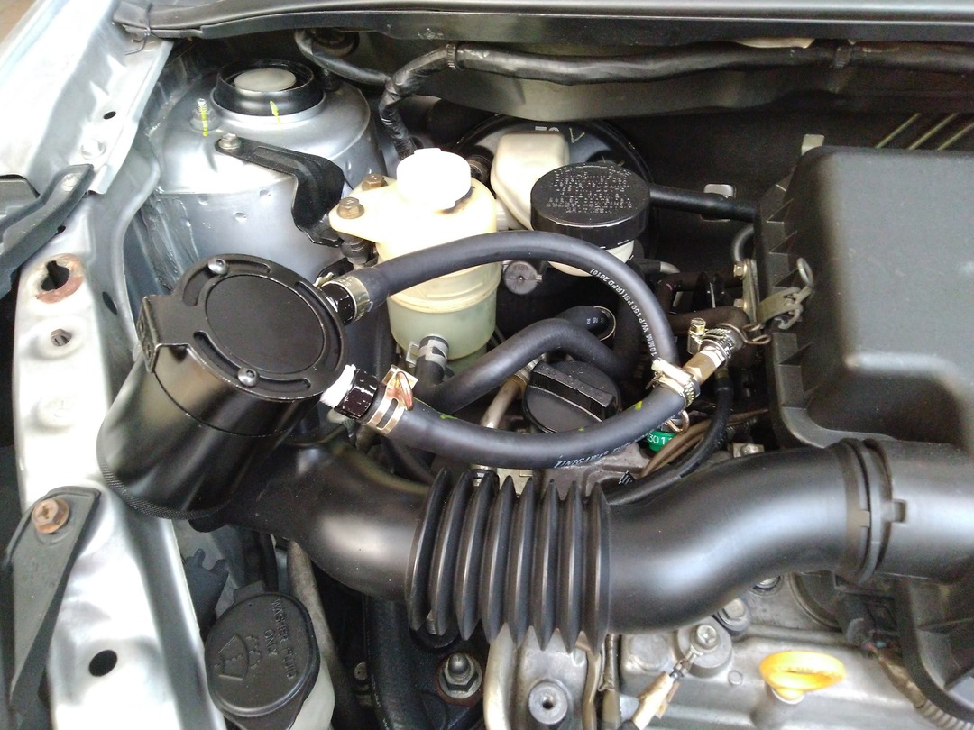

I never understood why engine manufacturers routed blow-by gases back into the intake manifold. All the oil vapour (read : Oil) gets trapped there and completely clogs the throttle body and intake manifold causing sluggish performance, inaccurate idling and in some cases engine dying off due to overly low idling.
In order to counter this problem, some budding aftermarket enthusiast created the Oil Catch Tank (OCT) and connected it to the PCV valve catching all the oil vapour therefore keeping the intake manifold relatively clean.
Picture taken from ZTH sales pages, copyright and all belong to the owner, not me
So I was thinking, is there a DIY-er way of doing this OCT without spending too much? Yes there was.
Tools needed :
1. Iswara Fuel filter
2. Automotive rubber hose
3. Clamps
Locate the PCV valve in your car (usually it's a rubber hose going from your cylinder head going into your intake usually before the throttlebody).
Replace this hose with your makeshift OCT and you're pretty much done.
The Iswara fuel filter has paper filters in it which will trap the oil vapour (read : Oil) and collect it in the filter. So be sure to replace the filter once it fills up (eventually). RM6 bucks give or take!
Enjoy! :biggrin:
Disclaimer : I've only done this for my Wira, Myvi and Toyota Unser without adverse effects. I do not and will not claim that this works for all car makes and models
