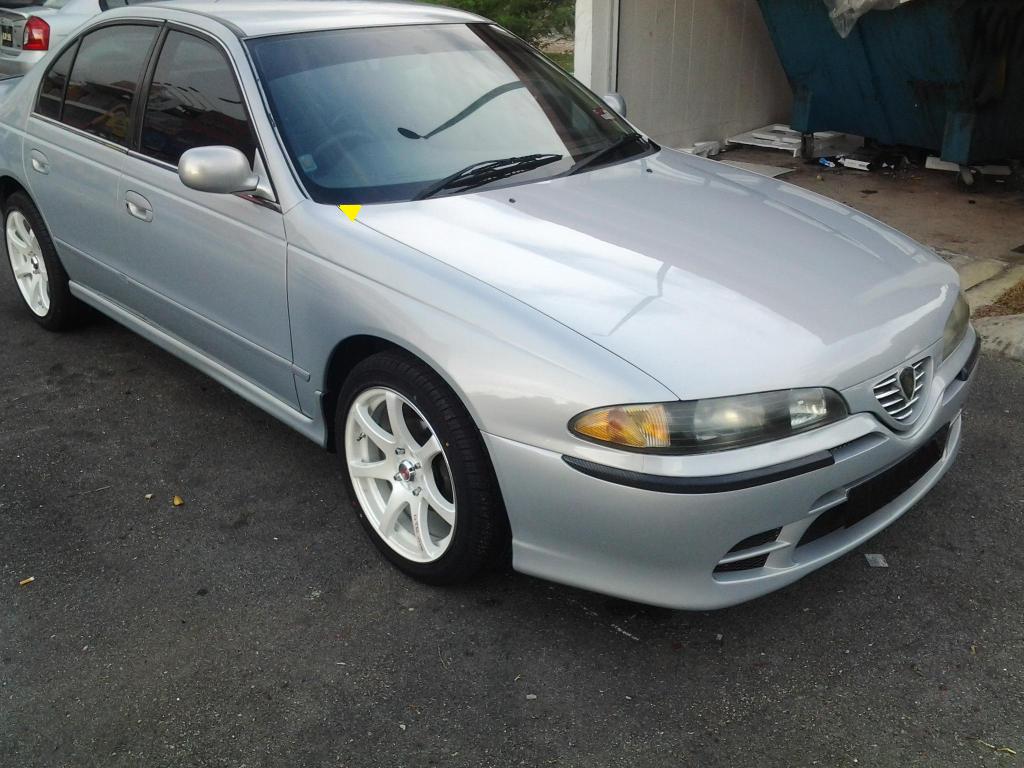

How to raise your car hood.. DIY style
u need to cut the yellow part..
not that big.. just around 15mm from the tip..
is that right Danz?

you're right bro, i raised my hood bout 1", but when i wanted to open the bonnet, the edges pressed on the plastic thinggy at the windscreen & had a hairline crack.
so i had to cut off the edges to raise my hood so that my rear turbine does not overheat, & it does help alot.

Am using perdana, which part need to cut off?
if u want to raise it abit (less than 1") then no need to cut la.....

raised the bonnet by using a nut only (0.3" height)...tried 2 nuts but will kena fender...not sure by that 0.3" height lifted, will it help in dissipating the heat from the engine bay...:confused:
of coz it helps cool down d engine bay.. :wink:
