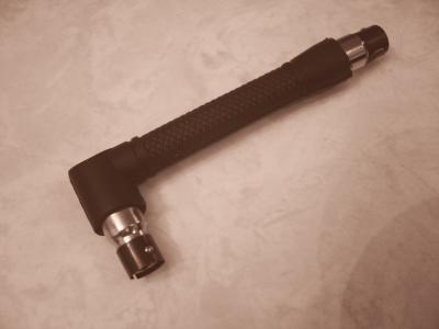

Step 4: There are 2 screw located on top of the MAF sensor. You need a very short "L" shape screwdriver to loose them.
