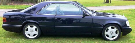

I WANT TO KNOW WHICH ENGINE IS BETTER TO REPLACE WITH MY OLD W124 ENGINE WITHOUT MAKE ANY MODIFYING ON WIRING .can in KOMPRESSOR engine aa?
