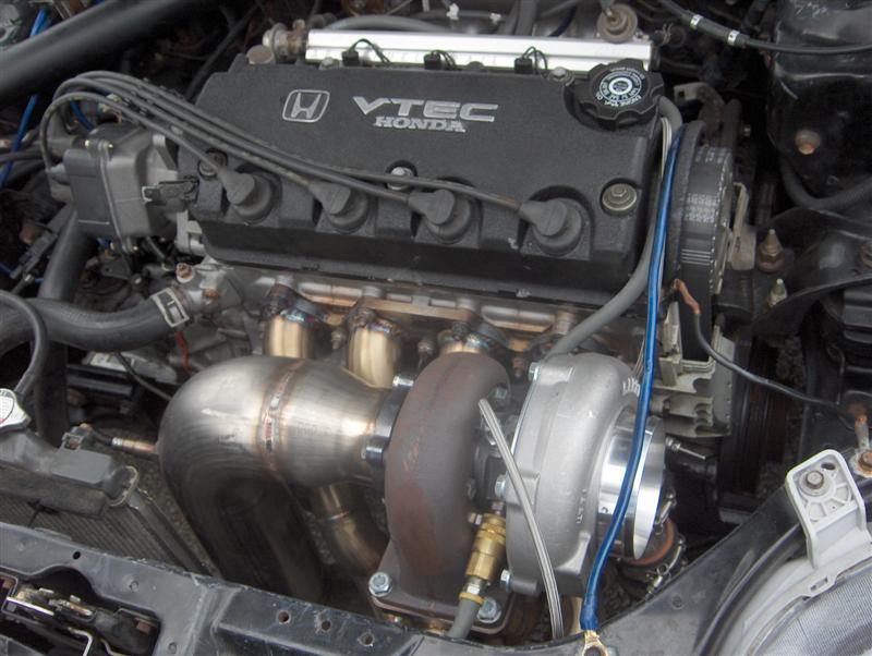

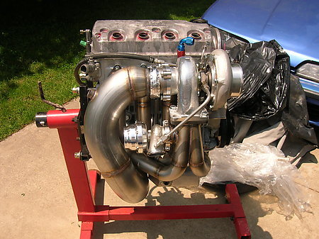

Jep, look at this Monster SOHC...for your inspration!! I have lotsa respect to all SOHC ROBOTS...maximize and squeezing your potential till GOD knows how many HP... some even ran till 400-450whp on SOHC. Simply amazing!!

equal length manifold n a huge turbine.... a recipe 4 power.. my car built 4 suke2 only... not like ur monster... will b glad 2 get 200whp...
