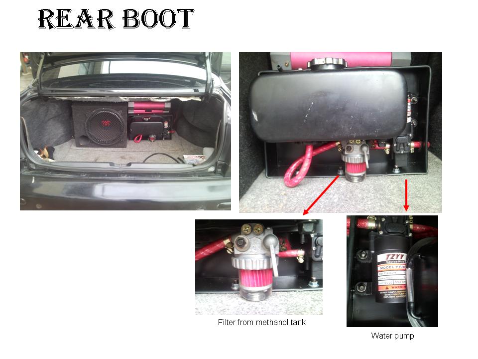

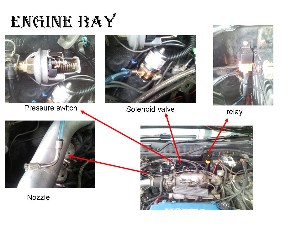

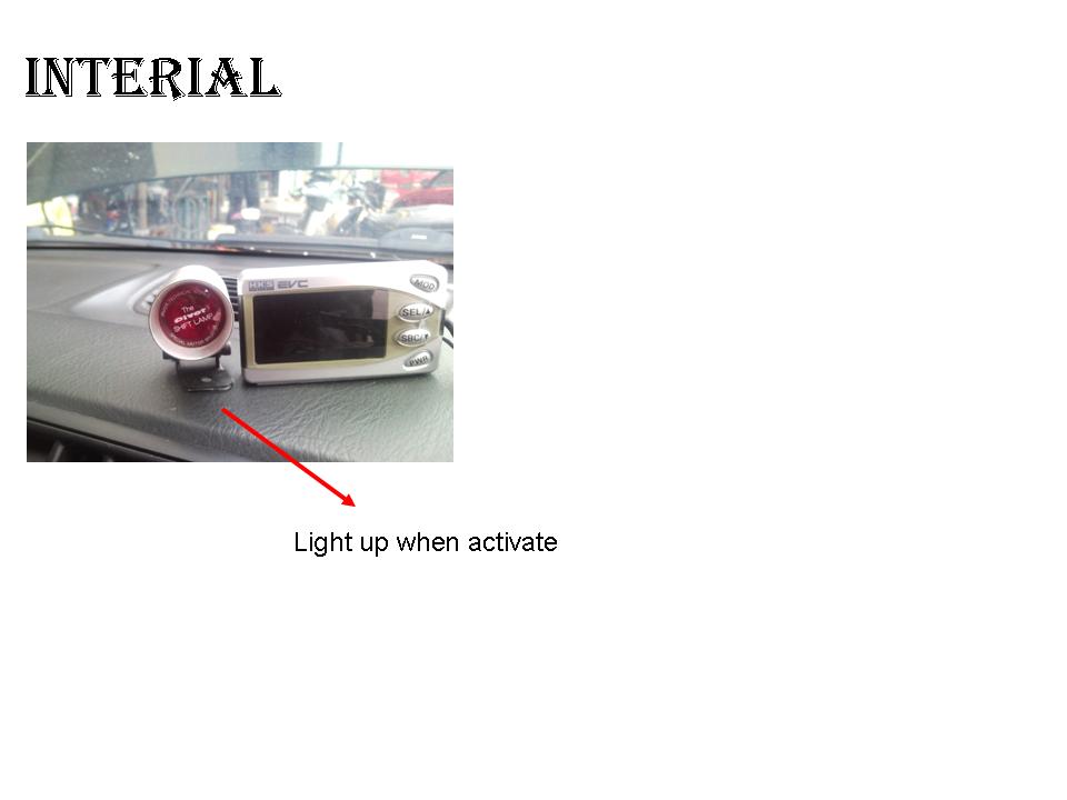

i just complete custom a water / methanol injection kit to my car,it activate on 0.85 bar.would like to install wastegate b4 tune my car.

bro, would u care to share about ur DIY water/meth injection kit. Really interested..

still under monitor the kit,scared d pump seal issue...comment good or bad are welcome
