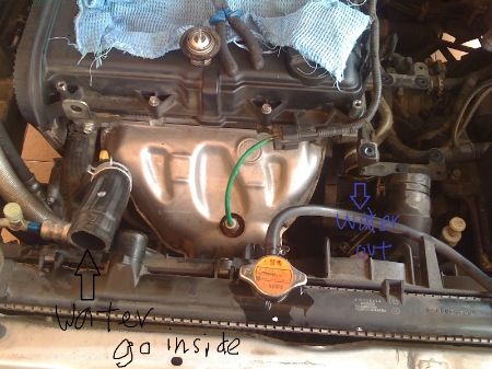

i did flushing old coolant like what izso did in his diy thread which is something like picture below.
Take off the thermostat so the water easy to flow out from the block.

From your picture I see that the water goes in from top hose?

yeah, i pour distilled water in from top hose and the water come out from the bottom thermostat area.
For radiator part, i jus release the drain plug.

Hi punk I don't understand this. If you run the water going in from the top hose, how the water runs past if the thermostat is closed? I thought that also runs counter flow to the direction of the water pump.

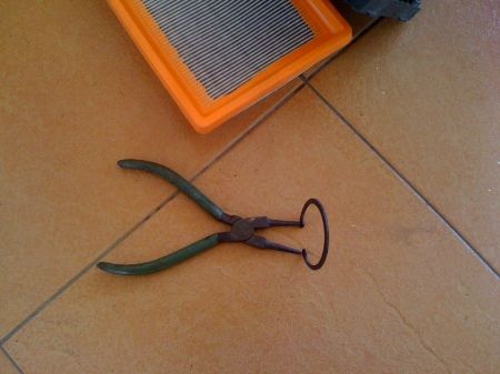

These plier got 2 design.
One type is to take out inner clip like in pic.
The another type is to take outer clip. ( i not sure how to explain :hmmmm:)
If u want to take it out the thermostat, please make sure u put it back the original position as u take it out including the clip.
Wear safety glass when take out the clip, my clip flew off damn far the moment i took it out.:ahhhhh:
I did this when engine if OFF :biggrin:
Look at the rocker cover, i already took off the thermostat.
If u did it when engine is ON
The water will run counterflow like u said.
