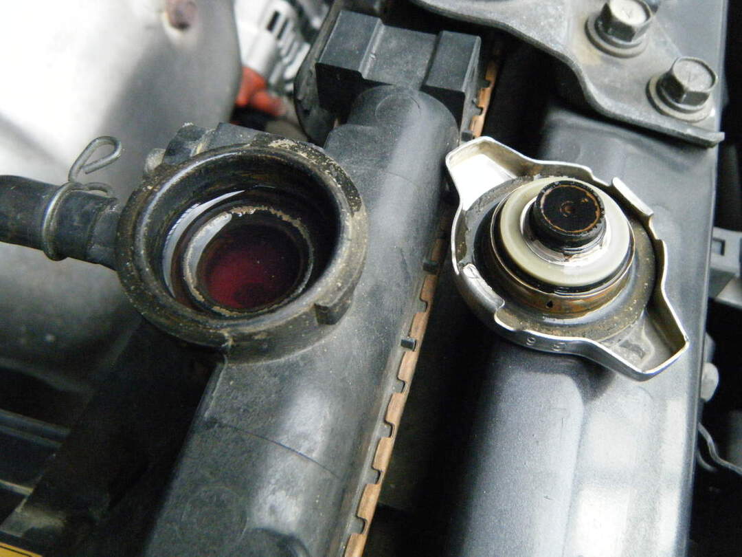

Update.
Looks like the weird substance problem is totally gone now. The radiator water clear and the cap is clean. Looks like these substances probably originated from the damaged thermostat. I just took a picture of it few minutes ago and this is how the radiator water and cap looks like.

Mean problem solved. Now just check that the fluid that goes to reservoir when hot and comes back in when cool, you are ok dy.....
Yeah. It has been 3 weeks plus already since I changed the thermostat. Temperature stable all these while although I din't drive my car much across these few weeks.
Huh? You mean the fluid in reserve tank? They are clean as well.
As long as water returns from reserve tank back to radiator means your radiator cap is okay also....:biggrin:
Oh, then I think it does since the water level at reserve tank remains the same. The water returns using the same pipe as the one that enters, right?
Yup, you still don't know how it works?
What hot the water goes to the reserve tank, then when cool it gets suck back in as there is a vacuum. Look at your radiator cap there is a rubber seal/gasket, this is sealing it tight. If this gives way then the water will go one way only, out to reserve tank and stays there as air will be suck in instead..... :driver:
