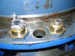

I saw magnetic oil sump plug before in a heavy mechinery transmission. It works by attracting metal debris in the oil.
wow, thats a lot of fine metal debris there. Love to see some on the sump nut of my engine
so that i know the DIY is working but again my engine could be in deep shit already if that happens.
I got magnets laying around, i think i should stick some on the sump nuts with glue,
some on the oil filter side, and probably some on my fuel line too. Who knows,
magnets could be able to super charged the fuel and add more kick to it.
