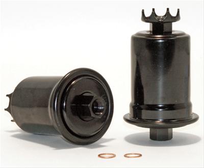

Yah! Mitsu ones are secure with bolt, something like this....

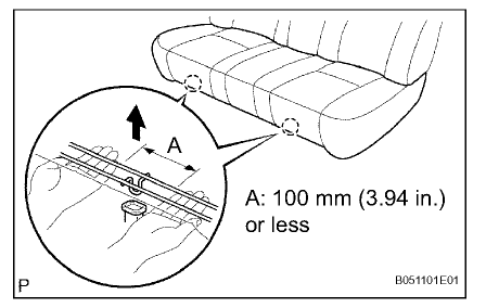

I'm gonna put some hopefully useful information over here for intank fuel filter replacement just in case some one like me trying to search up on DIY stuff.
There's a clip underneath the sit that can be taken out but have to be careful not to brake it
