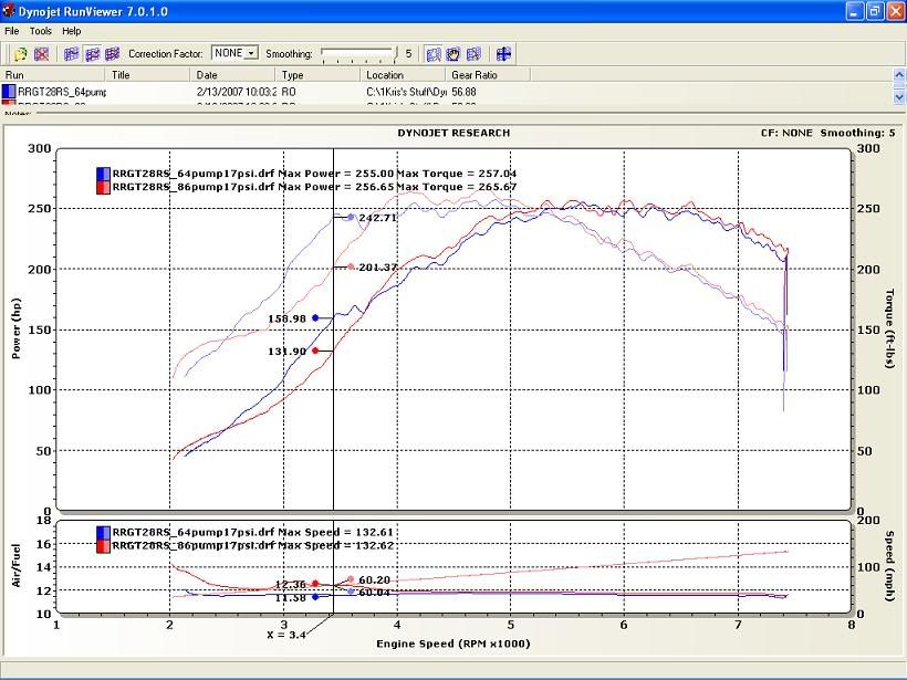

Oh Ya ~ This is the dynochart that I found ~ GT28RS A/R 64 vs A/R 86 ...
A/R 64 look more advantage than A/R 86 ~
Top end doesnt much diff ~!
