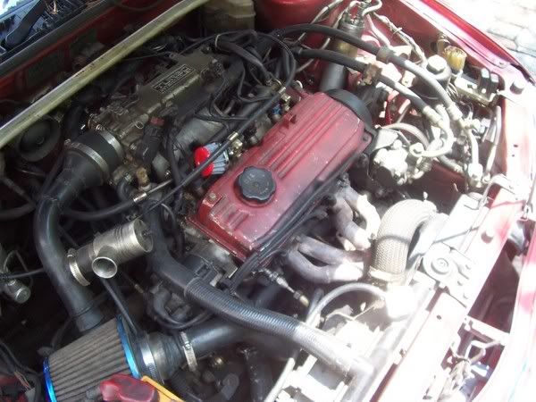

My kelisa with L5 kit, boost 0.9...
Din overheaT.. temp pretty as b4.

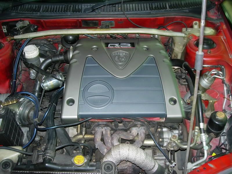

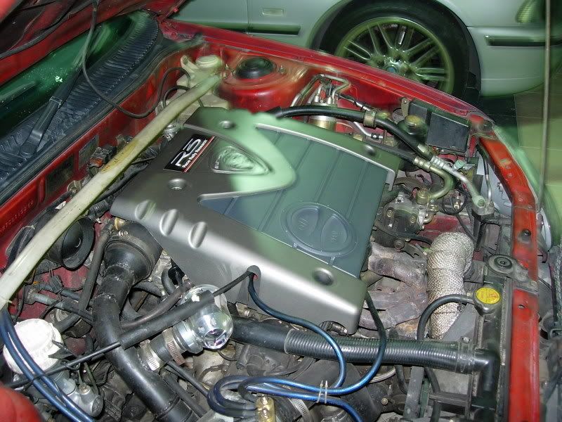

im not in serdang, just my fren live there, so he introduced me to the mech. the workhop's name is HSW MOTORSPORT.. behind south city plaza around there la....
here is my car pics, u can judge it yourself....
just after leave the workshop.....
current engine and still running! hehehehhe....

Savvyhitam : Nice engine setup u have there, nice engine cover, love the R3 logo on top of it... looks very nice. Your engine is very neatly done. Yes, I think many of us cant wait to TT ! So u decide when. I suppose bangsar will be great as everyone surely know bangsar. For sure weekend is the best.
