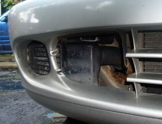

yeah ... i was about to !!! was busy driving around !! hehhehe :P
as i just got my car today !! came out of Drager Racing... second corner out...
met road block by traffic police... but they didnt even look at me... cuz my intercooler is black... and its almost invisible with the original grill... muahahahaha....
until now.. my comment is.. idling stable... pick up is responsive...
i dont dare to full boost for too long....because feels abit scary...feels like i am gonna ram something and get smashed....
i know.. dont laugh at me... i still need time to get used to it...
workmanship is excellent... boost at 0.5 bar...
so far still alright... will test it again and again....
to me... PS powersport is serving the purpose for me for now...
*fingers crossed*

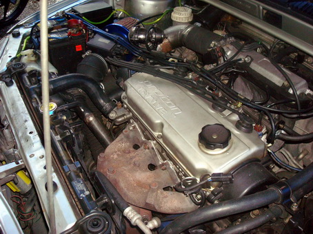

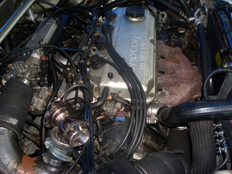

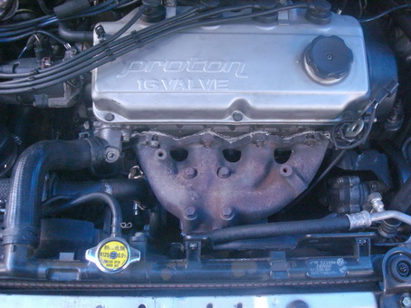

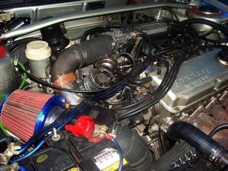

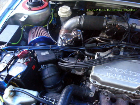

Hi guys..
just finished BoTting my car. the result..? superb.. ridding bot for 1 month already and so far no major problems.only minor problems with engine timing and FC.
anyone know mechanics (preferred in kuala terengganu) who could setting bot car..? RM70 petrol = 250km. if drive slowly, no boosting, maybe could go for 300km.
http://picasaweb.google.com/nayoer/4G92PBot
Bot spec (booting @.5 bar):
-hks blowoff
-TDO4L
-stendet gsr intercooler
-gsr injector
-stendet 4g92p manifold and pistons
-gsr air flow sensor
-sard feul regulator
here my car pictures.. ;)

I think you still need to fine tune. my car, RM 90 can go for about 750 km with little boosting. If boost like maniac, then can go for at least 450 km.
But then again, dont ask me why. All this FC thing are actually very subjective and relative. All depends on your driving style.
