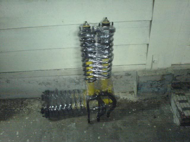

The spoon shockers I'm using is the yellow non adjustable ones.
They're a bit stiff, probably a bit more than GAB and Eibach and not likely for the everyday driver..
The car sits approx' 1.5-2cm lower than stock (guesstimate)
Photoes (old pics, before install and during the initial front end work of the car)
The shocks:

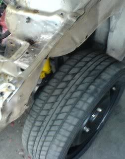

Installed on the car, undergoing front end work due to prev owner's accident damage. Notice that the brake lines are not installed, and there's only 3 lug nuts out of 5 on that wheel.. ROFL! And yeah.. I sanded some parts down to bare metal before finally leaving the work to a pro. That pro charged me 900 bucks for just the engine bay alone because he did the same as I did, sanded it down to bare metal.. ROFL! (cannot lose to a DIYer, mah!)
