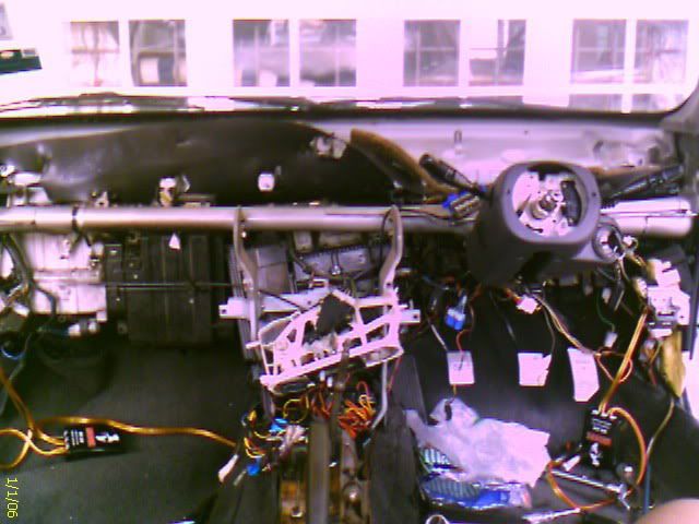

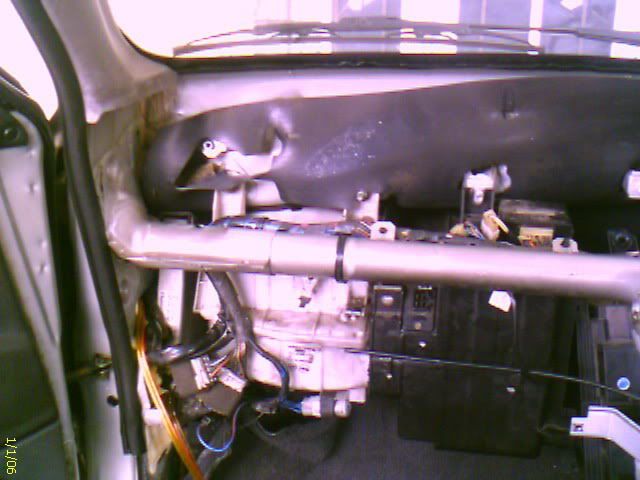

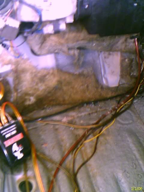

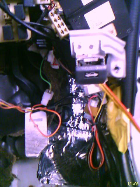

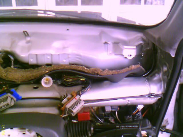

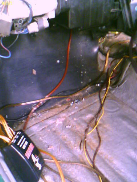

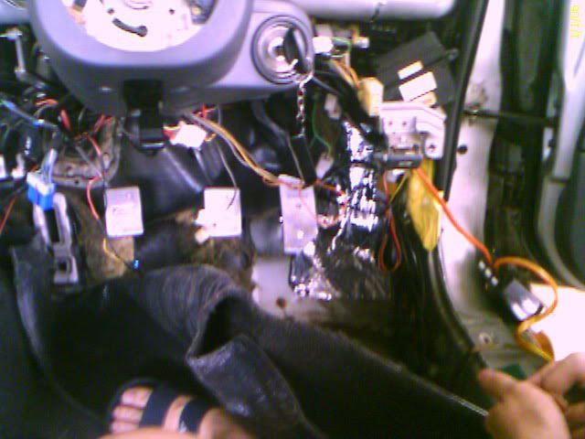

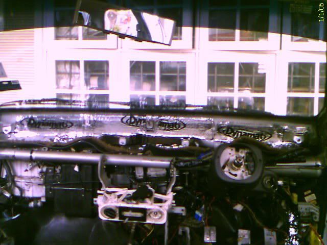

Here you goes... some idea for you .... we took 2 days to settle it...
we used the RTA to test it... about 10 - 15 db reduced...
wow. that's quite a lot of noise reduced.... but have to DIY ler... if pay someone to do, RM400 for workmanship also not enough.
yup... if better we can take the whole this... then we can do it nicely..!!

I mean the passenger seat.... there is a drawer infront... after you took off the drawer... you will see air cond... cooling coil...with the blower...
