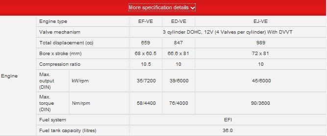

i think the number 1 is wrong about viva engine...
850cc use different piston size but same stroke...
as you can see above .. 850 using 66.6mm pistion while 1000 using 72mm but same stroke 81mm.
i get this spec from http://www.perodua.com.my/index.php?section=ourcars&page=viva&action=specs
