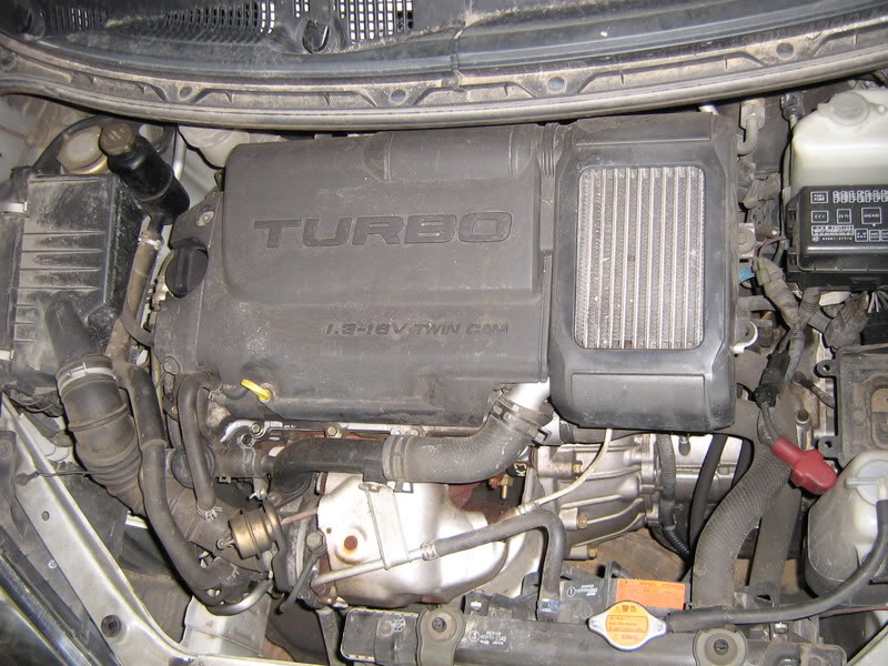

I really luv this YRV..im using viva 1.0 auto pll ask me to use Avy engine but the problem is i dun want to downgrade coz Avy come in 660cc..my question is If i want to use YRV to viva..is the mounting same?whats the price for the whole project?can be endorsed with JPJ? :wavey:

somewhere in kelantan, one already succeed..
viva with k3vet + tiptronik g/box..
try google it..
jpj endorsement should be no problem,
as many kelisa already endorsed with k3vet..
U got to make sure about the mounting 1st, Kelisa n kenari can use K3vet bcoz there r same mounting.
viva used the same block (ED series) as kenari/kelisa... the diff is the head (VE = DVVT equipped)
so in theory, it shud fit...
Even K3-VE will make viva flying since I've seen viva exceed 160kmh on the hiway :stupid:
ED for viva n kelisa 850..
for 1000cc, p2 used EJ..
660 use EF..
but mounting for viva n kelisa n myvi same.. for 660, 850, 1000cc..
to swap in k3ve, need modify mounting a bit,
as k3ve is 4 cyclinders engine..
same as myvi 1000cc wat to put myvi 1.3 engine..
n myvi 1.3 engine also coded k3ve..
myvi k3ve is diff mounting to the japan spec K3ve. If the viva can masuk myvi k3ve means u got to modify the mounting to masuk K3vet. Remember JPJ wouldn't approved easily once u modify ur mounting.
