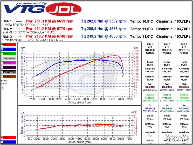

Maybe you guys will find these tests of td05 evo x turbo on 4age interesting
dynos performed on 4agte, 4agzte (same engine). Stand alone, 440cc injectors, 175mm crank pulley, sc12 supercharger, td05h-15g6-12t evo x turbocharger
run 1 - 4agte 1,2b
run 2 - 4agzte twincharged - supercharger blows to turbocharger. supercharger is disengaged at about 5700. Turbocharger sucks through supercharger - no bypas valve and as a result top power is not as good as with only turbo. 1,2b.
run 3 - 4agte 0,8b
4agzte gives much more response and fun experience than agte even though it gives less power in given setup.
