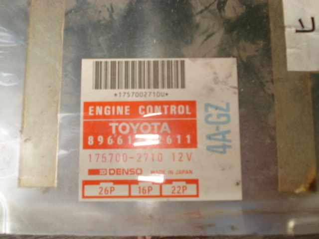

:confused:i need buy ecu 4agze to replace my ecu.....can you help me find and give me a call in this number 0168048137 jeffry.it a map sensor ae101
model.thanks

Hi Jeffry, 89661-12611 is from 4A-GZE AE92, not from AE101. Could you please confirm which one you are actually looking for?
Both i have it.
