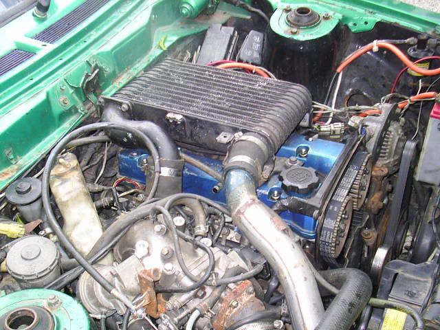

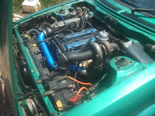

no la bro..i'm nobody..just wanna share experience with u guys..my sc14 installation are pretty much easier because i got plenty of space, but one of our forumer..long time never see him in zth..alex mebbe some of u knew him, i met him a few times in penang during tt..he already convert his ae92 to sc14..at first he called me and susah hati why his engine kept semput2 when reached 5000rpm..and i asked him what boost r u at during that rpm? he said he dont have boost meter, i suggest him to use the hks fcd coz i suspect it already boost cut at 5000rpm and install a boost meter..he finally installed the 4efte map sensor and no more boost cut till the end.he's using cusco big pulley also..if normal pulley maybe the boost cut not coming that quick..if map 4agze 1 bar boost cut i think.mine the cap ayam airflow one..no boost cut.:bawling:
my previously sc14 setup, modded bypass, 8" pulley, small+locked sc pulley (sebab magnetic clutch always kong), reduced diameter waterpump pulley.
my 'no money yet' 7agte setup
intercooler already bought but not yet in coz simpan duit to go for s/steel piping..not enough fund laa..:burnout:
currently running stock ecu, 450cc injectors, fpr set to 38psi, boost 0.7, stock ignition timing and 'very light right foot'..:bawling: just wanna share my set up..what about u guys? mebbe we can trade ideas..:idea:

very interesting setup u have there bro....aiyyaa...no wonder u said can fit in to your ride...celica body maa...tarik belakang one...:adore:
to tell u honestly, me and few friends keep thinking and lepaks2 talk about it, issue on installing sc14, cause lack of space/compression/other setup is always the main story..either in 92 or 101 engine bay..lucky i have shamburke with me...can ask for advise ler..hehehehheee...:biggrin:then we heard u installed sc 14 but very unfortunate dont have chance to meet u personally...but then after that, come across the idea of upgrading sc12 with other performance parts since cannot solve above problems...untill now still doing research and yet using stock engine...but shamburke and u bro turbo10 already went to next level..and i think we're lucky sc owner to have u guys..heeeheeheee....:adore::adore::biggrin:

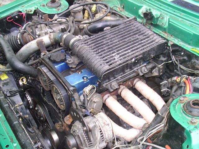

bro turbo 10..i notice in ur pic there u changed the place of ur alternator.. just wondering y did u do so..?

when i was using sc, the alternator sits really low under the a/c compressor on the exhaust side and hit my antirollbar so relocated to the power steering pump (didnt use the power steering). originally for 4age fr it is located at the intake side.in 4agze the sc12 occupied the place.now after ditched out the sc and install the alternator bracket from fr 4age and i also changed the alternator to ae86 alternator.so the original position is much2 better.that's why u can see no more ugly alternator bracket on top of the engine..and summore give space to the turbo intake piping.:stupid:
