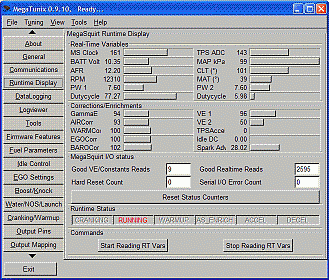

That night, i use digital analyzer to check on PW1 and PW2.
When doing injection, PW1 timming suppost same as PW2, but found out that is a lot off different, say 0.5ms ( direct from the main chip, pin 21 and pin 22 )
Then, i run on Megatunix software, and comfirm that the timming on PW2 is more then PW1.
There is a pic on doc.
Did your MS also look strange ( please check on you scope )
Please advice.
I did scope it out just for curiosity. Nothing strange with mine.
If it have that difference, than 1 bank will be richer than the other.
I didn't go to the extent of testing all those bits since I believes the
MS team would have done vigorous testing to their design. Running
it on the engine too are smooth and have no jitter.
You might have some inteference to your input. Try to shield that out.
Here's the screenshot.

Cipan,
You quote:
"You might have some inteference to your input. Try to shield that out."
Bro, if i have input inteference, the PW1 and PW2 will read up and down, but it seem to be constant.
Can you please run on Megatunix software, capture the pic and save it on doc.
Thanks in advance.
Cipan,

At night, reflash the 918 on version V.
Restart the setup/configuration one by one, and finally, found out the problem, the configuration on "DUEL TABLE" fueling.
Master Cipan, you are right. MS team would have done vigorous testing to their design. So, please accept my APOLOGIZE...he...he...he
