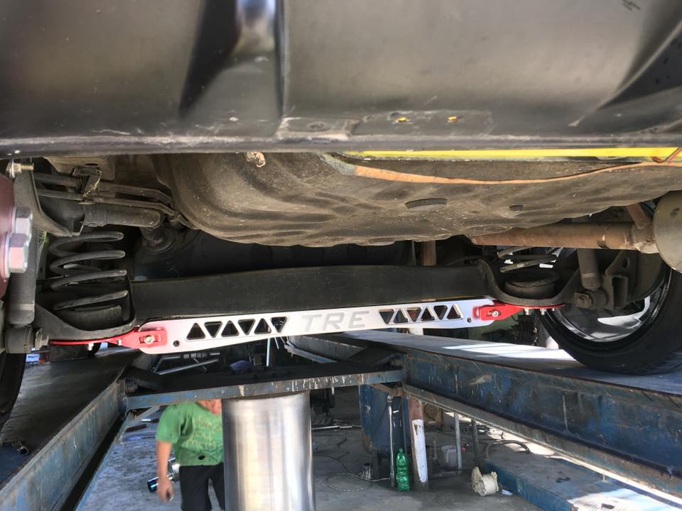

any difference between ARB and subframe?
Subframe
https://scontent.fkul3-1.fna.fbcdn.net/v/t1.0-9/26239858_1506496249446394_8253331547576018757_n.jpg?_nc_cat=104&_nc_ht=scontent.fkul3-1.fna&oh=74c6026d40891b1ba77cced0a2db4079&oe=5CD0EA40

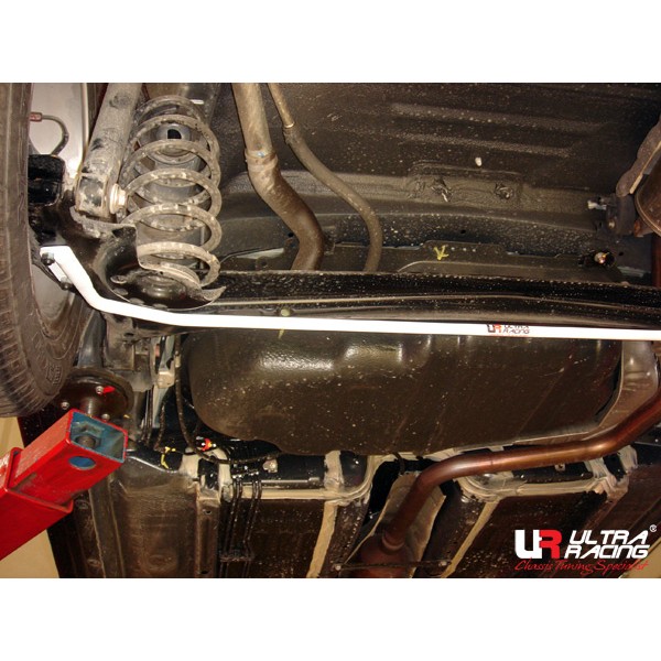

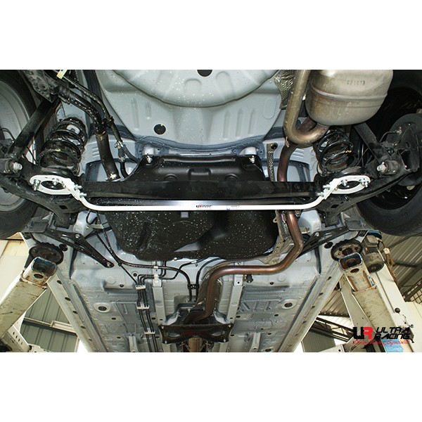

ARB
well, apparently, UR changed their design in their 2013 ARB to simulate subframe design
http://ultraracing.my/ecatalog/index.php/product/toyota-vios-1-5-2013-rear-sway-bar-rear-stabilizer-bar-rear-anti-roll-bar/
torsion beam stiffener cuz the beam does twist under stress. A lot of stress though is required to twist to that extent.Cant really see the purpose of this
