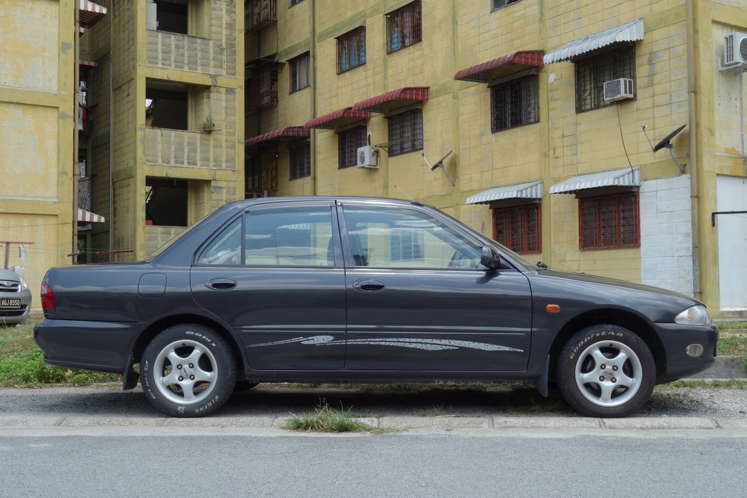

Standard APM spring. I din't like the higher look too at first but now I'm used to it and the car does perform well, so I'll just leave it like that. I believe after some time, the spring will go a bit lower by itself when it gets older. Despite being a standard set of spring, it is quite a stiff spring. I won't call it soft at all.
I have attached a photo of my Wira's current height. If you want to know, originally Wira 1.8 is supposed to be that high when it came out from the factory. Look at this old advertisement photo of it. The front looks quite high isn't it? Kinda similar to how mine looks like now.

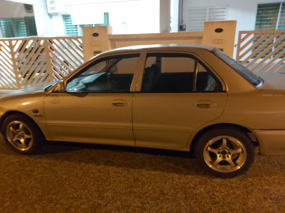

Your one is rally wira but it is good you satisfied what you get now(stable). Let see mine height front and rear I get around 3 finger. But my front absorber is not new condition, I buy from chop shop and take to service(inject).
