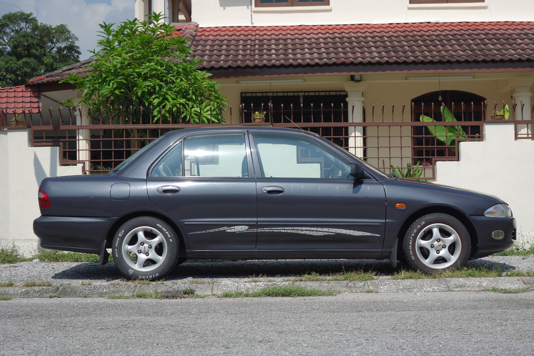

Your Wira looks older than mine. Those first batch Wira carburetor 1.5 at year 1993 to 1994?
Yes, mine does look like rally car now, which is unbelievable that it still corners stably. This means that the new springs and absorbers are quite hard enough. Your current height is almost like my height before I change my suspension. Maybe your front absorber condition is no longer in a good shape and even after you service it, it still can't perform well.
Anyway, you can try to equip a rear anti roll bar like what I did to see if your stability improves or not.

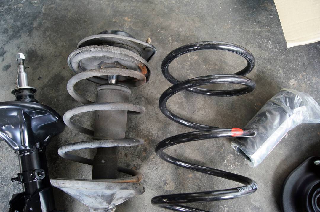

This is my car's height before the suspension upgrade to 1.6/1.8 type. If you want to compare, this is how thick and big the 1.6/1.8 front springs are compared to the normal 1.3/1.5 spring. Definitely harder spring rate.

I thinks your rim 14inch, this caused the gab to fender is much more higher. I am planning to upgrade 16inch
Yup, his wheels overall smaller, therefore more gap.

From the looks of your photo, I think yours is also 14 inch? Actually, originally Wira 1.6 and 1.8 are also using 14 inch wheels.
