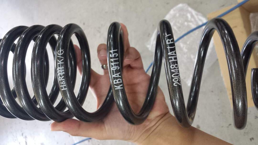

It isnt written on the springs itself....I attached the pic here.
Any advise sifus here???

from the pic....
i think spring lenght is 290mm with 48Nm/mm a.k.a 4.8kg/mm rate (4.8k what ppl do call it) for rear....and i personally would say it is a bit harder than common proton tipical rate on rear....
so height drop maybe need running in time...try drive over speedbump slightly faster to get faster running in of the springs :biggrin:
None of the stamping indicate the spring rate.. those are just serial numbers. Most german makers (eibach, h&r, vogtland etc) don't really publish spring rates because they are progressive.. and they are secretive :hmmmm:
Ah! now I know why some have and some don't.....:adore:
