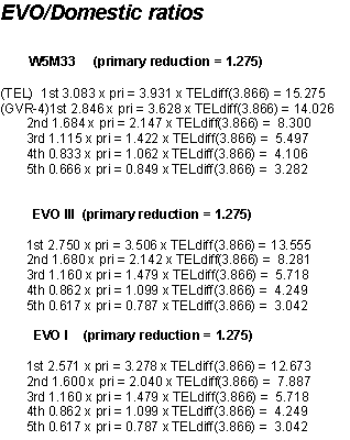

guys, i would want to know if any of u guys know the RPM vs Speed for the GSR gearbox on gear 3 and 4
thanks a million
hope this help bro
