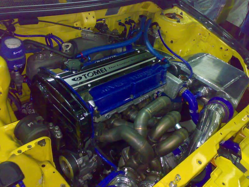

Intercooler... If purely for drag purpose, check out this 9 secs car from STWANGAN.
No air to air intercooler. I assume it's water cooled intercooler with the water pumped to another cooling source with the temperature controlled by dry ice. This can prevent evaporation of dry ice if it's being kept in the engine bay.
Yes, PNP. But if u only change the final drive, the last gear would be too long. Then, 5th gear will become too long. Load is going to be high and boost will drop. Couple with GSR 5th gear and final drive into a EVO GB. Then Cunz...
