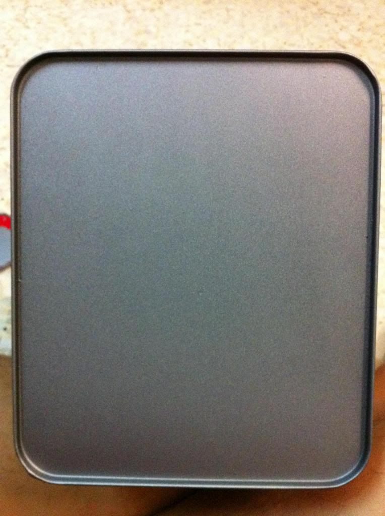

1. One good thing about AIKKA PD is that they can do whatever colour. Notice the mark A08 BMW. I actually bought BMW Metallic Grey.

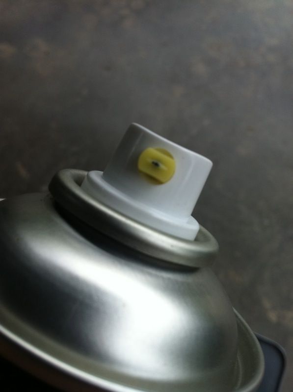

2. The spray nozzle can be adjusted to be horizontal or vertical, and spray pattern is better than Performix PD.
3.This is after 4 coats. Notice that the texture is smooth and nice. Not so rubbery unlike Performix PD

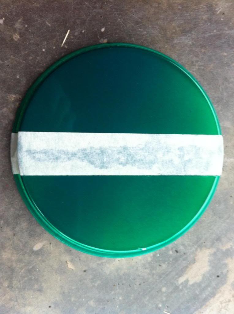

4. I sprayed a few layers of normal paint on a panel and then top up with Aikka PD
It seems that the aikka pd doesnt stick well on very smooth paint without the primer.

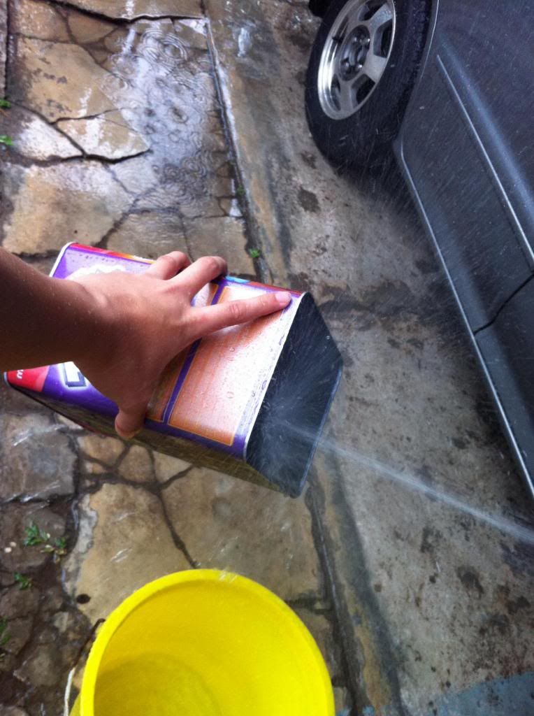

5. Water and washing test. MF towel can be used to wash AIKKA PD.

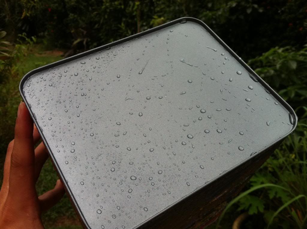

6. How water stays on AIKKA PD.

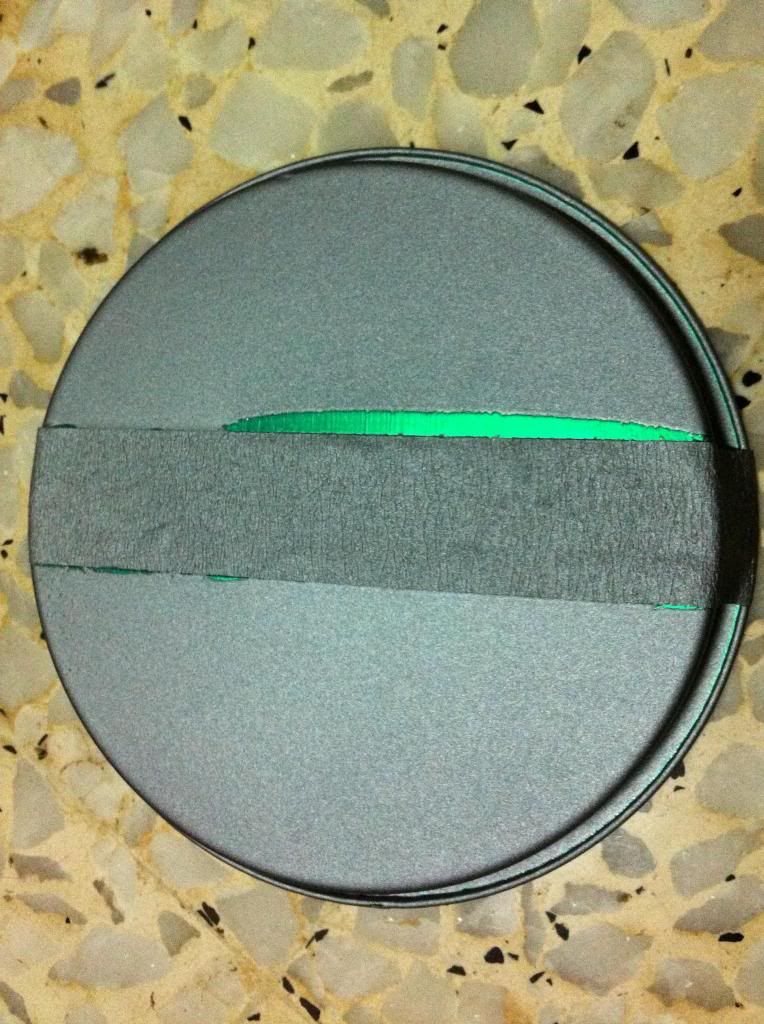

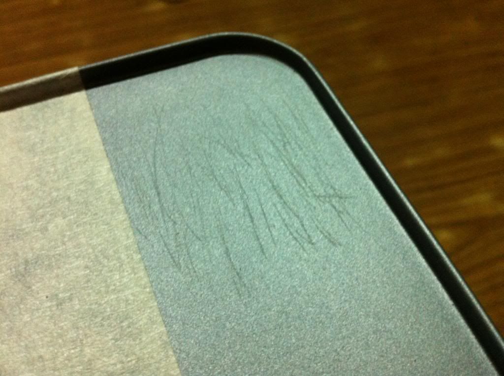

7. Scratches !!! Aikka PD is very soft. The scratches you can see here is from my fingernail, and i did not even press on it. To repair the scratches, AIKKA told me to just spray another thin layer on it.

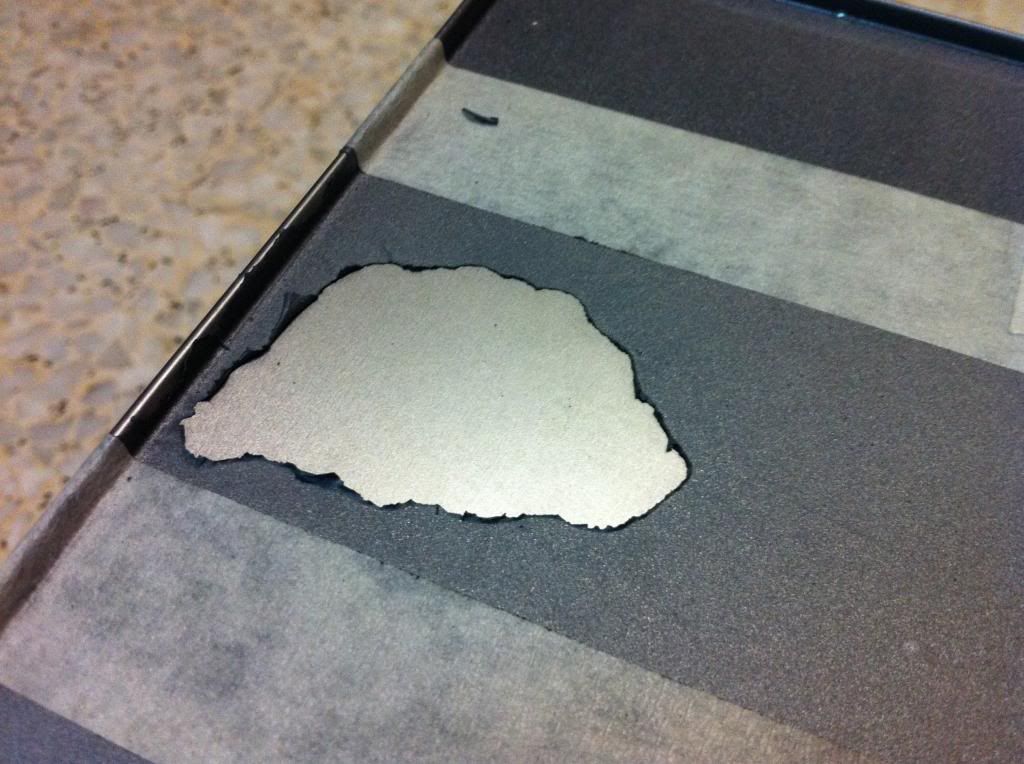

8. Peeling. Without the primer, it is DIFFICULT to peel! It does not stick together like Performix PD. Peel a little bit and it will snap. I gave up after peeling this much. I have not tried it with primer yet. But I believe it is a lot easier to peel off with primer as I'd seen somebody has done it in youtube.

a. Have to use with primer, if not it is very very difficult to peel off.
