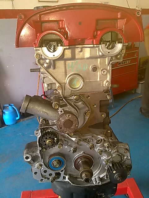

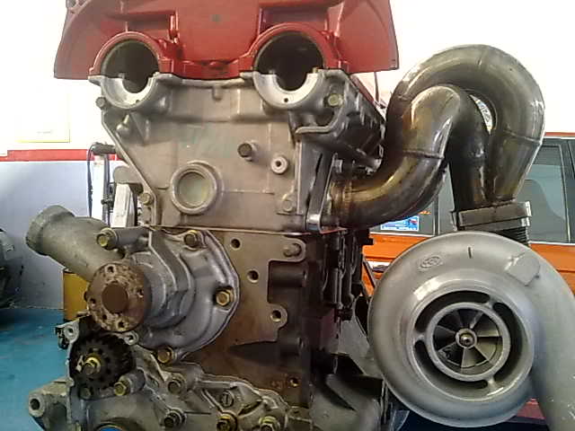

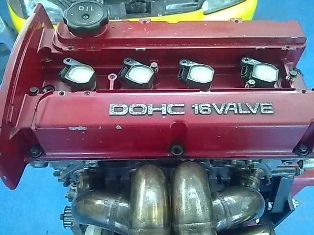

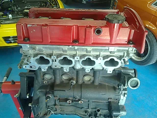

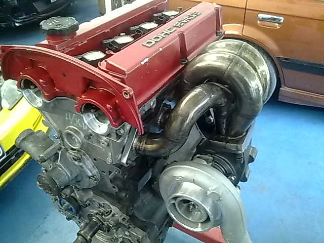

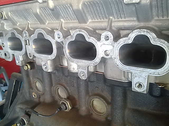

This is SportCompact Racing 1st Stage Rebuild the EVO 4-6 engine.
1.Head Full Cleaning
2.Cutting Valve angle
3.New OEM Valve seal
4.Tomei cams 270deg
5.HKS cam Pulley
6.Pen Type Performance Coil
7.ARP head Stud
8.Custom Turbo Manifold
9.Turbo Bullseye S256 little snail.
10.Cometic Gasket 1.5mm for bginner.
Internal Stuff
1.Wiseco Forged Pistons 86mm
2.Forged Rod
3.ACL Engine and Rod Bearing
4.Polish Crank
5.New Oil seal Crank
Haltech Platinum 1000 Engine Management.
The Best ECU for person in Malaysia
Good Budget with A Good Power.

My Salute to Syahz...
Meleleh air liur oh...Dam,really wish my engine could transform such as this...hehehe
Abang Syahz,what is the good budget as mentioned if without the Ecu as i aledi hv pfc...
Thanks Bro,
How many HP you want.I can advice the stuff and your budget not over.
Thanks Bro,
Actually,if can get 360~380whp i will be truly happy...
Is there any PnP turbo for my existing td05hr with banana manifold?
I hope can save as much as i could.
Thanks

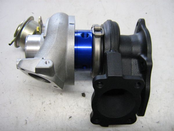

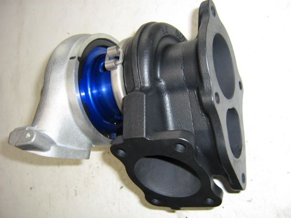

James for your PnP turbo have no idea.But i can advice,u can use billet turbo do the Billet catridge for your turbo.But the price it's not cheap.Better u change the turbo and Manifold.Pls look the sample of turbo from Billet Australia.I sold many turbo to Filipine and south africa.
