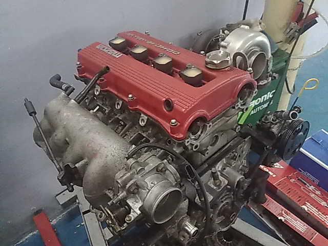

Mazda B8 Turbo RWD engine.Can install for many type car RWD old school.Easy and Lower Budget but Power Engine
Stuff On Engine
1.Mazda 210 engine
2.Head Stock BP8
3.Stock Cam
4.Custom Valve Spring
5.Intake and throttle body Miata
6.Forged Piston
7.Forged Rod
8.800cc injectors
9.Turbo IHI
10.Haltech Platinum 1000
11.Extreme Clucth Aussy
12.RX7 gearbox with adapter plate
Syahz
Aug 14, 2009
484
21
Australia
Now i start build for my wshop geng.For RWD old school one.Buy the car chip one and low cost,put that engine.weekend lepak2 and Yumca.Starting from stock bolt on turbo and EMS around RM8+++.

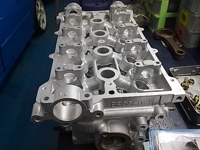

Come to my workshop and face to face if your are serius for making Crazy Monster.I can Quote and Advice what to do.No worries buddy
Look the Miata Head crazy clean.ready to boost
