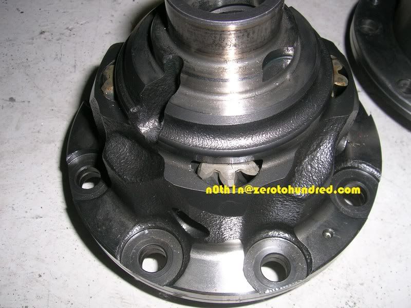

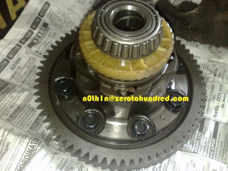

A - because the final drive was bolted/welded on the differential itself....so means if u change diff unit with LSD type..most likely it comes with shorter final drive.....no excuses....
B - even if u swapped gearbox....those LSD equipped GB mostly got shorter final drive....dun believe me u can google the gearbox spec.
C - maybe u can retain the final drive if your differential unit comes with bolted final drive tooth...(means can change the tooth)
a - yes its bolted/screw, not welded. ive never seen/heard someone welding their diff to the FD, i dunno about others.
"so means if u change diff unit with LSD type..most likely it comes with shorter final drive"...
exuse me, short mean what..4.1?? please explain 'shorter final drive'...bcos my layman term to describe FD is big or small. 4.3 is a baseline as we knew thats the stock supply for c52/56.
so big = >4.3 e.g 4.5-4.7-5.2 etc and small = 4.2,4.0,3.9 and so on....
b - i dont believe u. googling gbox spec for what as they normally didnt equipped with lsd while some does but it didnt change fd though.
people normally, change the differential unit only. FD is another different thing, unless it is welded together as u mention above. u can get a new set of kaaz lsd at some of the perf shop in here, and hey it didnt come with FD. if u swapped with other/different code of gbox (c52 starlet/c60) thats another story bcos they have different final gear ratio.
c - u dont need to change, just take out the old one and change the lsd unit...unless u have alot of different set of final gear. i believe the thread starter here refer to c56 ae111 gearbox...maybe its a different thing to RB's since u are the GTR pomen, or maybe it is defferent to other car/brand...or just like my friend satria since they have few different models and gearbox ratio.
