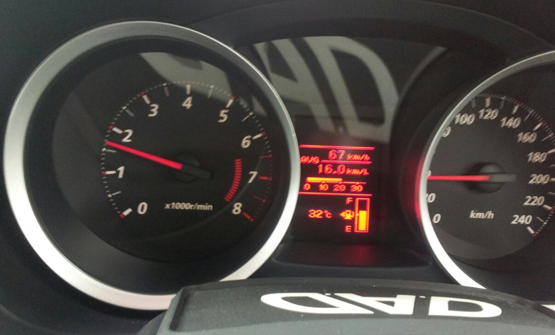

Inspira Fuel consumption
Inpira 1.8 mt.stock engine..k&n drop in filter.
Retune ecu..for better pickup n topspeed..
70% hiway 30% normal road.
Air cond on...
3 adult inside the car..
Maintain 100kmh on hiway..just 80km distance
This my fc

yup...last time i drive like maniac achieve 6KM/L...now i do 9-10KM/L....
lower than 8KM/L considered crazy already...
all figures are based on dash meter...not actual calculation...
Dash econometer is not accurate at all. It only tells you your average at that point in time, not the real average.
