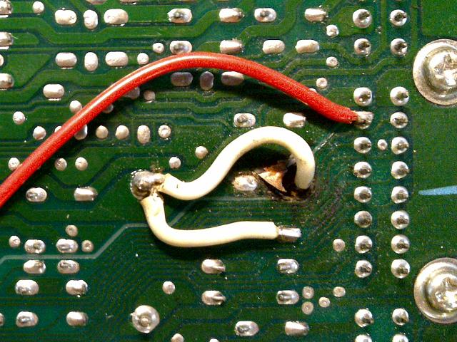

Check your ECU!
It just take less than 30min and you need not pay anything for it.
Hey Levin818... Is there any risk of taking the ECU out? I'm afraid if I damage any sensitive components... then my car no need use dy... And I need to figure out how to access it as it is sort of behind the dashboard... Where do I start unscrewing... haha...

Check your ECU!
OMG... I just tried... SO damn hard... I tried removing a bit of the dashboard so that I can acccess easier but it is so hard and so many complicated wiring... So I fixed it back and tried just to take the ECU out... But the screw is so tight as if it is welded there already... WAlau... I think I take to the shop and ask them to remove la...
Hi Veloc,
Its better to ask your mech's help to remove the ECU. They use to those screws and nuts stuff!
After removed the ECU, take necessary precaution as what i have mentioned in the earlier page.
If you want to send your ECU for repair, make sure the repairer give warranty on his work done. If he don't, don't let him handle! Simply because he do not know exactly what he is doing and might ended up damage your ECU!
Good luck bro!
