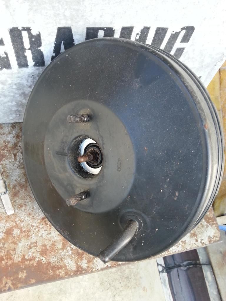

If not mistaken evo 3 servo can fit.
price should be rm 180 - rm 230.
Yes.. Evo3 servo pnp. But make sure you get a good condition one. Otherwise just buy a new Waja WC la. No need to mod. Peace of mind.
What is WC? :confused: or you mean MC? :smokin:
---------- Post added at 09:12 AM ---------- 6 hour anti-bump limit - Previous post was at 09:06 AM ----------
When buying your MC get the same size bore or bigger. Smaller then you will need more force to brake.
Sizes are like 3/4", 7/8", 15/16" something like that. I changed before and my VR is Mitsu so uses Proton parts too.....:driver:
Thanks very much for the info , really appreciate it =)
Just did some google search & found out if I install vacuum servo from another car will need to customize/cut the metal piping from the MC which I feel not safe to do such job on the brake system =X
But that guy install a Vacuum servo from a Nissan to a wira , I'm not sure if this is the same situation as EVO 3 Vacuum Servo into Waja , link is here :tacra's diy garage: Double Layer Servo Brake
Please give me your opinion guys .
Thanks again =)

Don't mod the servo. Get one that is larger and that can plug and play.
Something like what I did. I transfer from VR half cut to my Super Saloon. Then my super saloon one to my Wira 1.5. VR one is like double layer, Super Saloon one was single layer but bigger then my 1.5 wira ones....all plug and play....:driver:
Wilson13B
Dec 15, 2010
296
30
528
The thing is the vacuum servo seems plugnplay just the metal piping to master cylinder was not in the right position ....
I in favour of double layer vacuum servo feel ... My SLK & E46 had ATE double layer vacuum servo as stock system and the pedal feel is great ... I wonder if a evo 3 vacuum servo on Waja will provide the same nice & firm feel if not close to it ~
