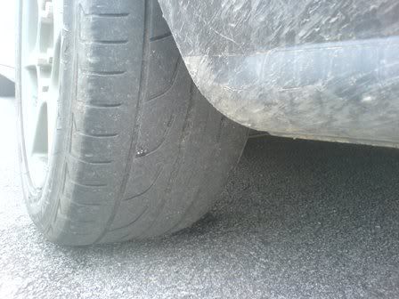

Resurrecting the tire thread... haha
Been running the RE001 Adrenalin for quite a while now (a year plus?), and they're due for change. Touching the treadwear mark already. After correcting camber, tire wears evenly now. Worth it to correct the camber when driving long distances. It doesn't affect tire wear as much as toe, but when long-distance travelling, it counts.
Review wise,
Tire doesn't aquaplane easily even with 20% threads left, unlike semis.
Grip gets lousier as thread wears.
(this is pretty normal, except for semi slicks which has best grip in mid-wear limit)
Sidewall is strong (I kerb'ed and escaped with nothing but a slight scratch on the sidewall)
Treadwear is so-so. About the same as my RT-215s previously.
UTCQ rating is 280-AA-A (which is about right)
Have to replace em' now
So went to the nearest shop to get a quote.
But I got a shocker on the pricing.
RM390 for ONE 205/50R15.. WTF?
Anyone know's of a better deal? or it looks like I'm going to be back to Neova's again... with their less-than-great wet grip. <sigh>

im using adrenalin too but 195/55r15..last time about rm300 per piece..quite mahal kot bcoz x sempat survey dat time..was really need to change.would like to try neova if cheaper but then wet grip issue..
That's about right, but if you're using 15x7JJ, 205 is a better choice.. see above picture I added to my earlier post.
