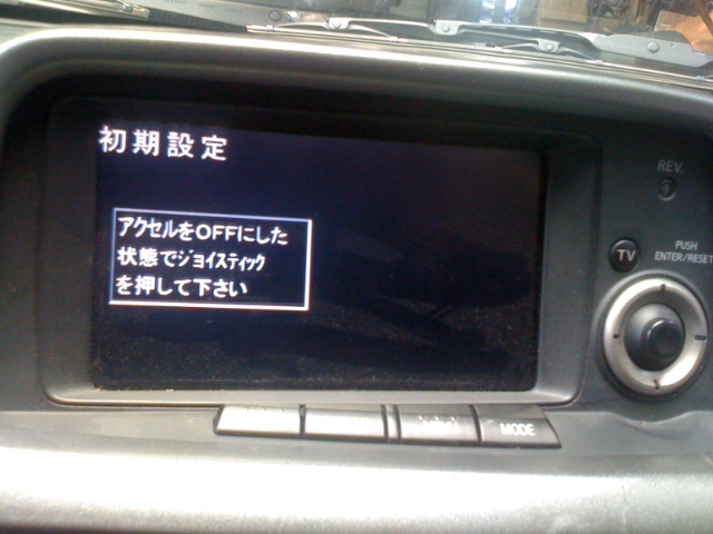

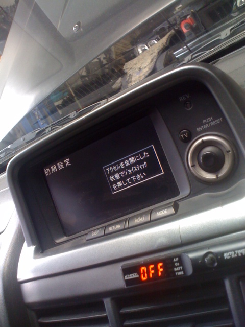

my BNR34 V-Spec facing some problem with the MFD, the screen only appeared 4 japs words, after translating its "initial setup" and some other words which we don understand. it is a square box appeared in black n white..then the GTR word doesnt come up white i crank.
anyone has such experience, please advice me what to do. thanks in advance guys....:adore::adore:

i am attaching some pics here...u help me translate and see if it can be reset or so..
thanks alot bro....thanks bro kenny & rokok.

bro Evo,
1st pic - Initial Setting
Push the joystick when the accelerator was in full open
2nd pic - Initial Setting
Push the joystick when the accelerator was in OFF
Sorry bro..i oso confused the word 'Zenkai' means full open or full push..if direct translate then it will be full open..might be full push the accel..hope it helps!
:smokin:
u r in a mode for calibration of your TPS.

i tried and my problem solved...thanks BNR & Rokok Sebatang and all bros here...cheerz
