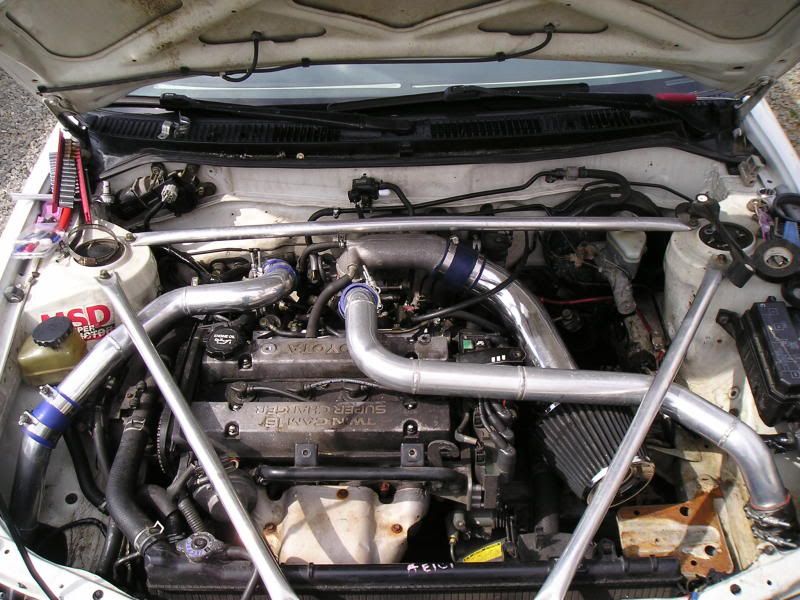

This is my setup now;
FMIC using Vr4 IC
Bigport NA camshafts
Rebuild the vacuum lines (thanks to Shubert)
My boost did drop to 0.9 (max), this is caused by FMIC? Do i get power loss from boost drop? I cud easily go over 1bar at first gear before i FMIC. And the fuel consumption is higher compare to the setup before. Difference by 50km.
Anyway, i hope you guys understand what im trying to ask here. Any advice given here is very much appreciated.

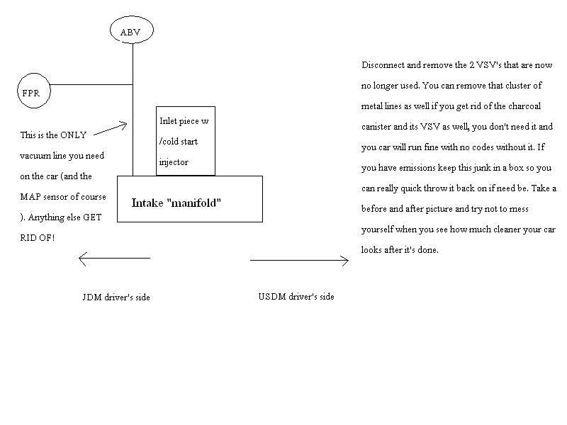

Dude, u have a diagram or something for those vacuum lines? I need to check mine...thanks! :biggrin:
what i meant abt rebuilding the lines was, removing ALL vac hoses except for MAP and Fuel regulator hose. you will see that the SC will engage faster

this is the original diagram
http://toyotaownersclub.com/forums/uploads/1185393830/med_gallery_1879_14_15497.gif
---------- Post added at 09:14 AM ---------- Previous post was at 09:12 AM ----------
below is the vacuum hose mod
---------- Post added at 09:16 AM ---------- Previous post was at 09:14 AM ----------
then it will look something like this
ah...I've done that already then. heheh...nothing else is hooked up except my MAP, ABV, FPR & boost meter... :biggrin:
