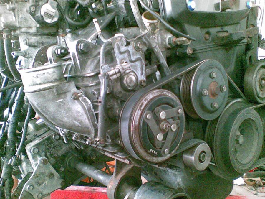

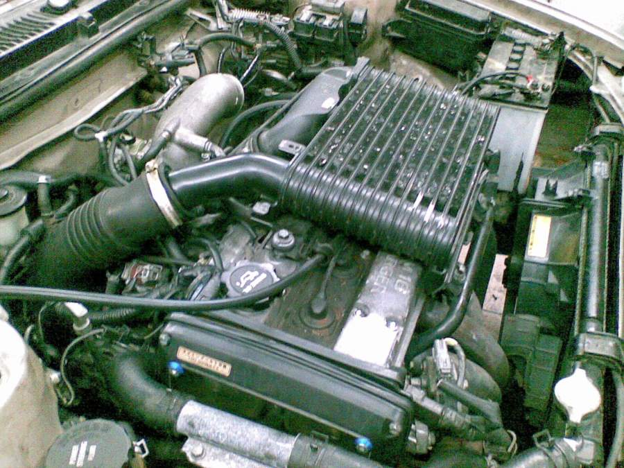

However after installing the SC14, i have not full rev it yet. the vacuum hose to the IC cannot stand the pressure and flatten the hose when the car starts. Making my hose breaks into small holes. gotta make steel pipe for the IC

i have successfully installed sc14 in my corolla. I have problem when revving high. The rubber hose from TB to IC looks like a balloon want to explode! I tried using good quality air hose and it didnt last me more than 15mins. Imagine the massive air that this SC is blowing. FYI, im still using stock IC
i guess its either i make a steel pipe to replace the rubber hose or FMIC (last choice). i just want to test and see if the Top IC can stand the heat as well as the air. I guess not. But the last owner used stock IC to drag.
Will the FMIC (VR4 IC) causes lagging?
BTW, im currently boosting 1.2 bar at 40% throttle. cant go full throttle coz my IC pipe wont let me
right now IC not yet complete. i will guess if everything works fine, i might be able to boost above 1.3 bar

my engine is not complete yet, waiting for the steel pipe connecting my TB and IC inlet.
attached are pictures with SC14 installed
